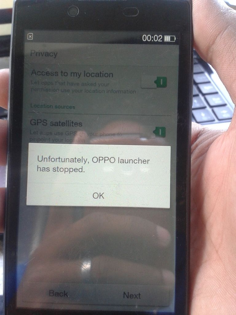

oppo r831k sdcard lng ang gmit ko.

share lng nga boss. bka makatolong sa ant.
tested ko po to sdcard lng gmit ko.
eto ung gamit ko...http://www.mediafire.com/file/wvaorxiqzed7jq7/R831K_11.A.16_OTA_INT_all.zip
sir pa share ng step by step procedure thank you.
Sir Madaming step kay uncle google po hanapin mo lang po flash r831k through sd card papakita papaano
tools na kailangan mo lang e
SD card
put firmware inside the sd card no need to extract file
as is nka zip ung file then boot your phone to recovery mode
pressing volume down and power
kung ayaw ng down ...use up then power
wipe cache and data
after that install through sd card wapak na yan
gumamit ka ng magic search button marami jan
some unit cannot enter recovery mode so u need to use sp flash tool or other gadget
but be careful read thread here at ant gsm or use search button
