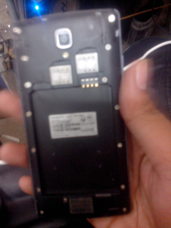

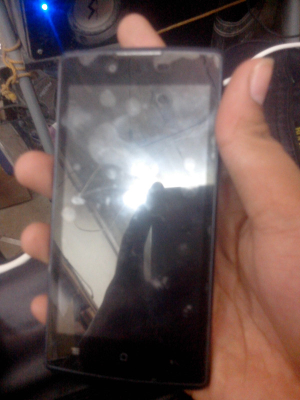

History: Sabi ni tumer na bigla lang daw nawala ang display kakadownload niya ng games
Di naman nahulog o na ipit so try ko sa power supply, may power ngunit nag vibrate lang
so saksak ko yung cable, yun dumetect sa pc kaya try ko flash sa spft.

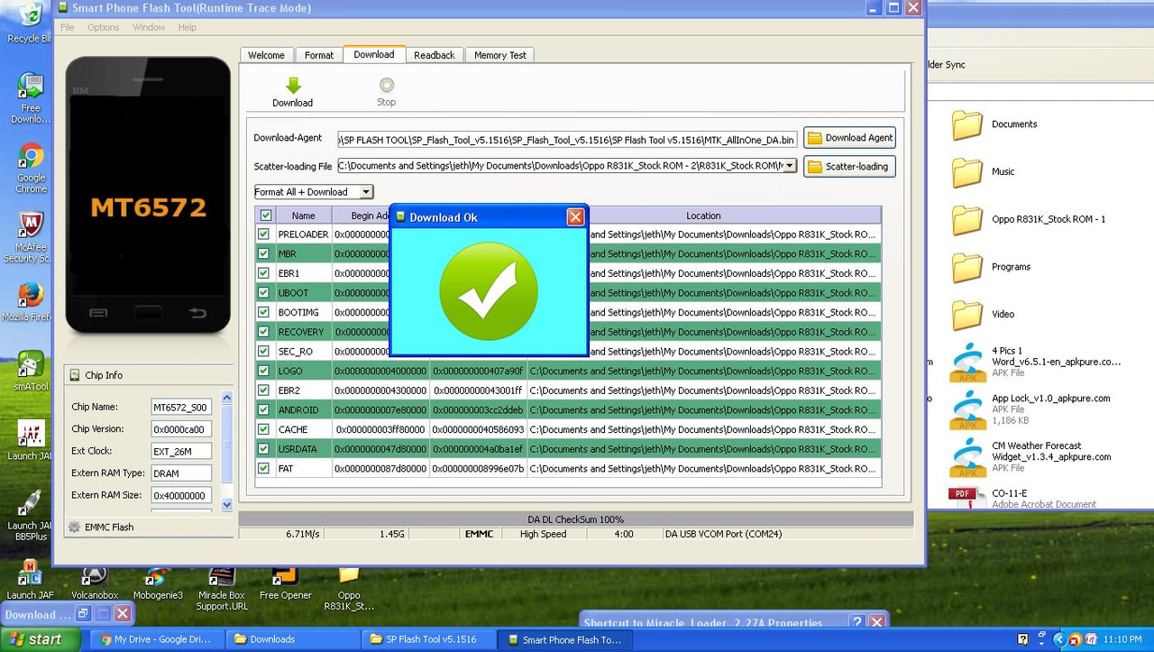

SPFT > http://spflashtools.com/windows/sp-flash-tool-v5-1620
Drivers > https://mega.nz/#!hlpmnaCZ!KaNDQuSwq0kHCDLBunkzwGKsuCug8H60fIGjfYRbInM
Stock Rom : https://mega.nz/#!xlxwUAYD!lJNS1-0SVt60TRAYkhg6uy2dvKg3HN4VNvKd5m3wXyA
Load scat. file
Select Format+Download
Hold vol. up(minsan sa down, pero up yung sakin)
Saksak to the max ang cable
After done. ok na pera na!
Done na. nag display na ang unit. ok imei working cam lahat ok :D
