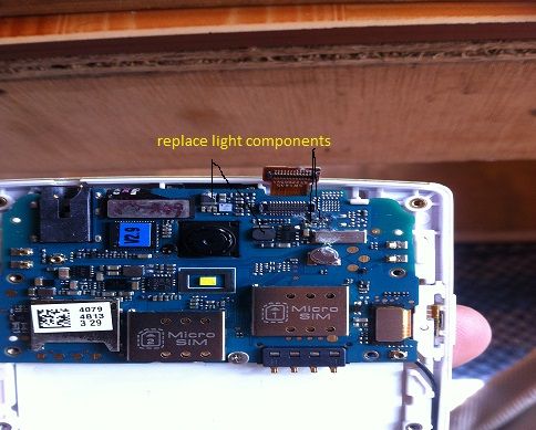

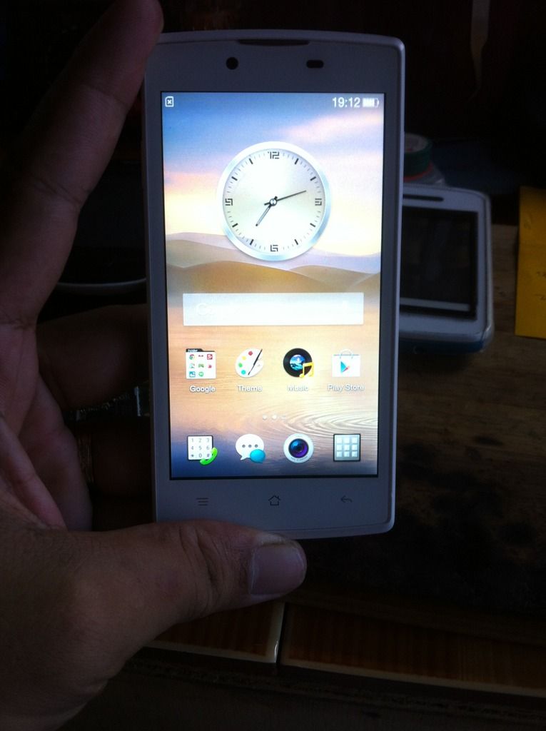

Share ko lang po.... OPPO R831k water damage , no light....
<textarea style="width: 500px;" readonly="readonly" class="ncode_imageresizer_warning" id="ncode_imageresizer_warning_1">Click here to view the original image of 765x1024px.</textarea>
<textarea style="width: 500px;" readonly="readonly" class="ncode_imageresizer_warning" id="ncode_imageresizer_warning_2">Click here to view the original image of 879x657px.</textarea>
replace lang po yung mga light components..pwede tayong kumuha ng pang replace sa nokia board like 1202, 1280... sa part ko after cleaning lumabas naman yung color ng mga components so dun na lang ako nag base sa color coding ng mga parts...
