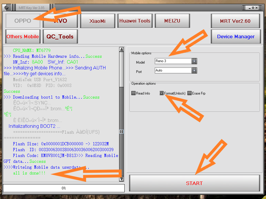

JGD Registered Joined Jul 17, 2014 Messages 354 Reaction score 159 Points 51 Location Dagupan Tabuk, Kalinga City Jun 5, 2021 #1 Oppo reno 3 CPH CPH2043 Pattern Done mrt Needed: MRT V3.92 Usb Cable Procedure: 1. CLICK OPPO MODEL RENO 3 2. FORMAT 3. START 4. Please, power phone OFF, press and hold "Vol+" and "Vol-" buttons and connect USB cable. AFTER DONE USE DIAL *#812# DONE
