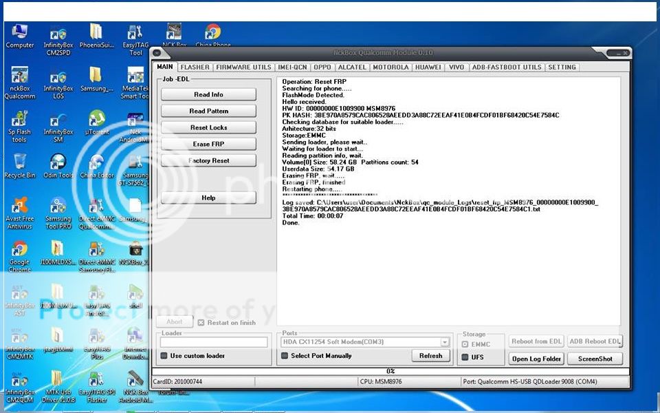

share ko lng po mga ka antgsm for reference (oppo X9079) frp.. try ko sa cm2 dongle ayaw mag conncet..nxt try ko sa nckbox saglit lng

image ng unit
tools
loptop or pc
nckbox activated
usbcable..
procedure
open nckbox qualcomm module
install qualcomm driver kng dpa na install
click erase frp
press vol, up vol, down insert usbcable
wait until done....ayus
screenshot..log,
