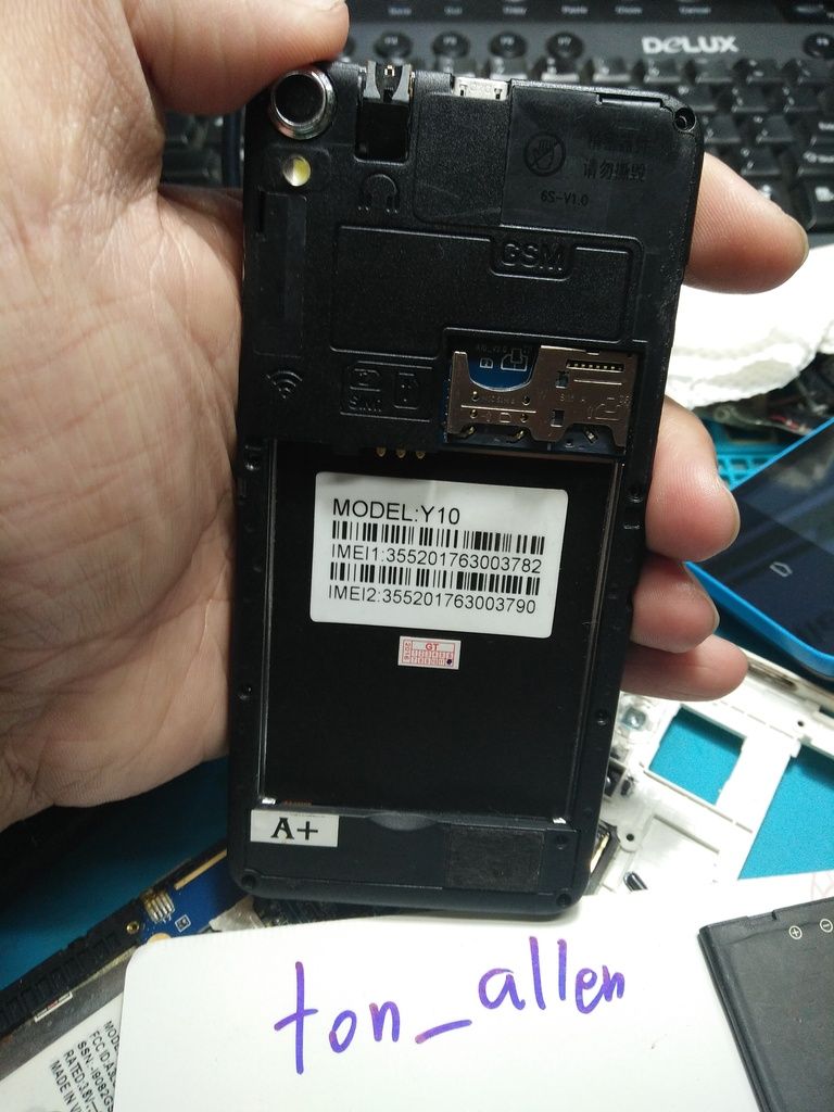

UNIT: OPPO Y10 (CLONE)
PROBLEM: pattern lock
ACTION:

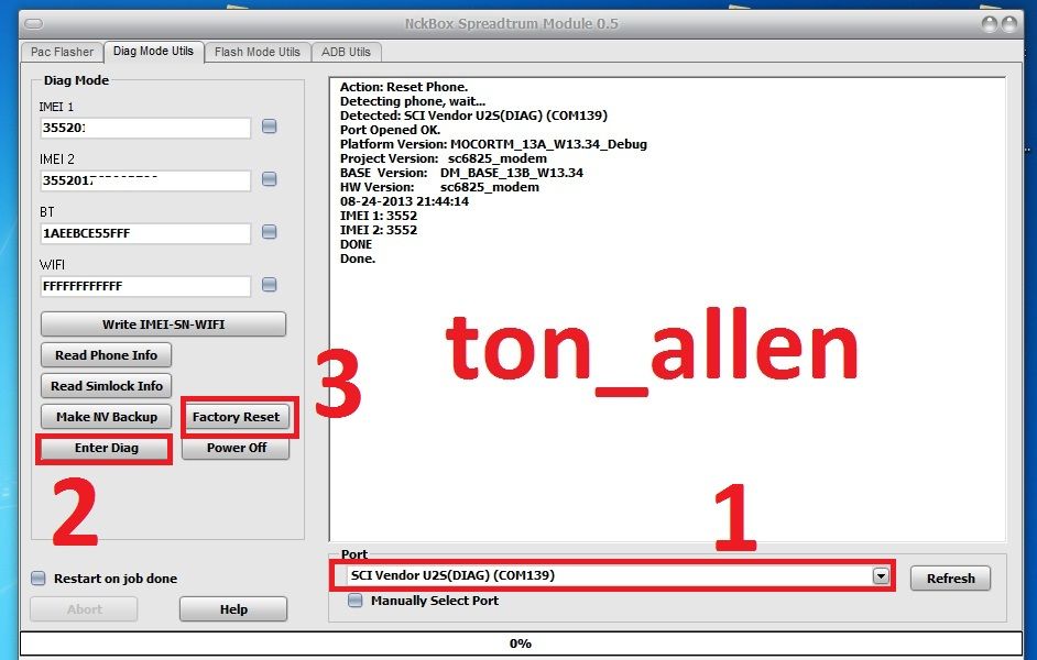

power on ang unit
connect sa pc
hintayin mag install ang mga drivers
-Open NCKBox Spreadtrum
-Select correct port
-Select Enter Diag
-Hit Factory Reset

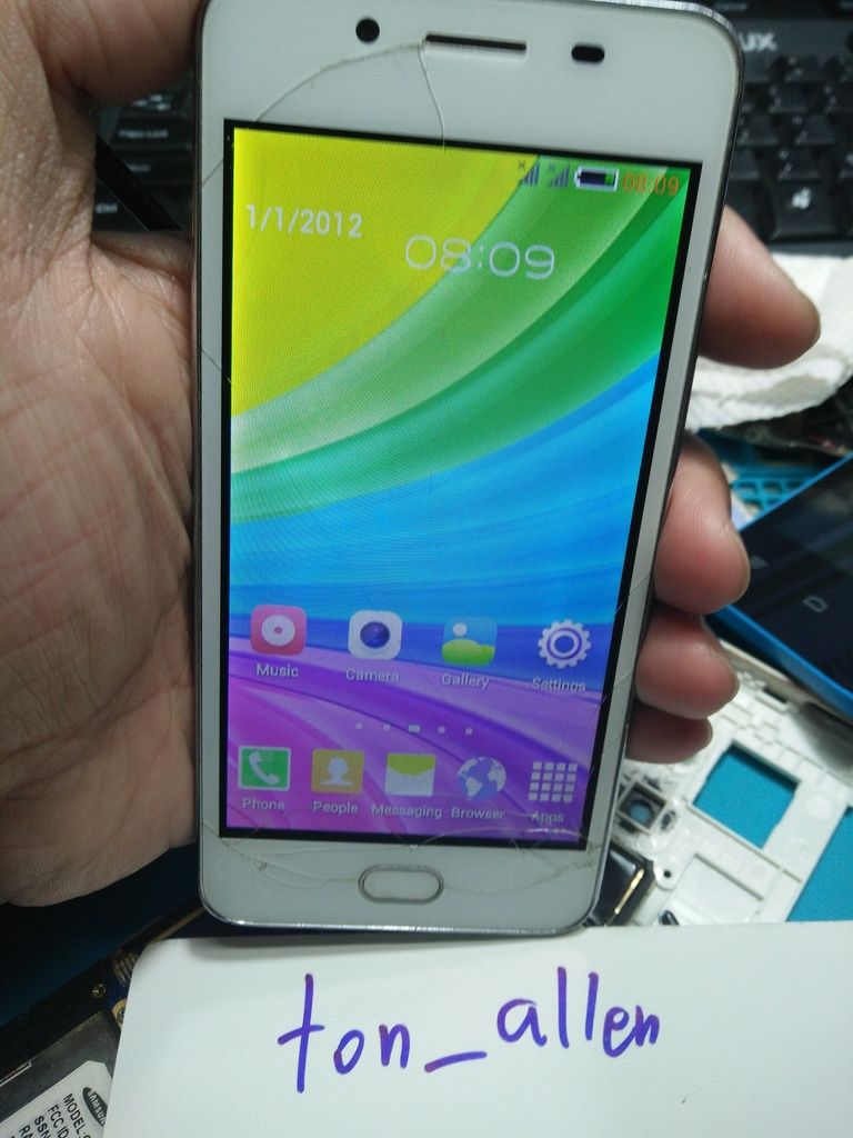

DONE:
