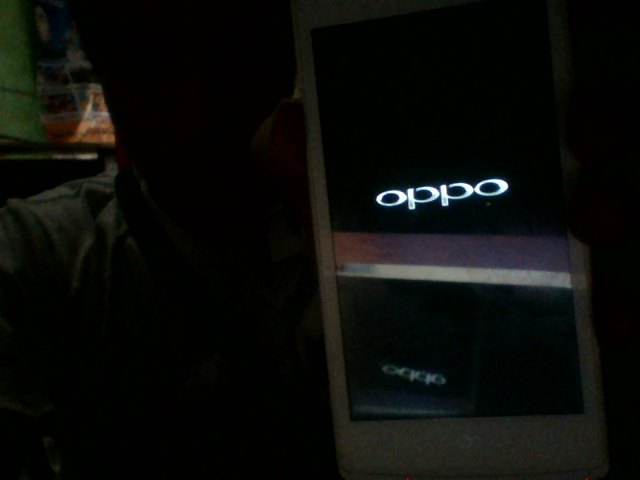

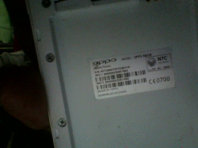

oppo r831
hang logo

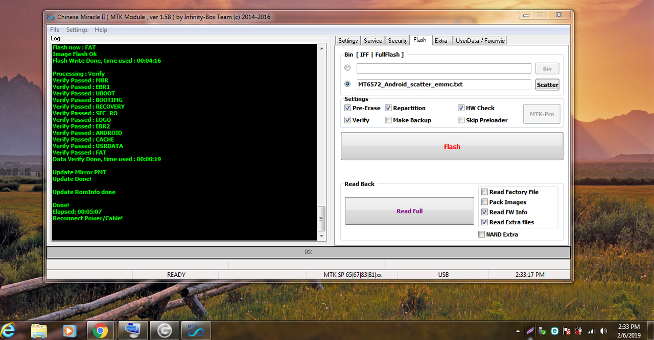

procedure;
1.https://www.4shared.com/rar/ger5lomHda/R831K_tested_nck_bim.html
2.open cm2
3lagay scater file sa cm2
4.flash

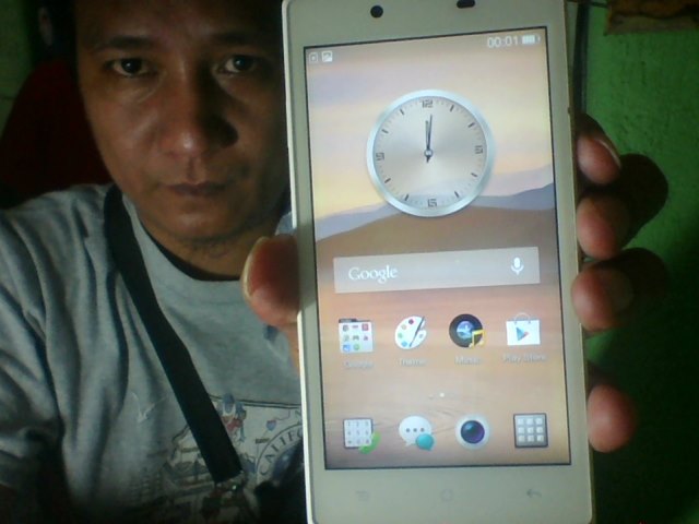

5.wait matapos ang flash
6.open ang phone
8.done
