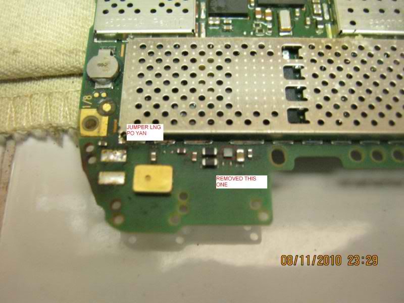

MGA BOSS SHARE KO LNG PO ITONG GAWA KO E71 CHARGING NOT RESPONCE
TRY PALIT CHARGING PIN 3TIMES PERO NO LUCK
TRY PO LINIS ANG PIN PERO NO LUCK
TRY KO PO MAGHANAP NG SULOTION DITO SA tahanan natin ALA AKO MAKITA

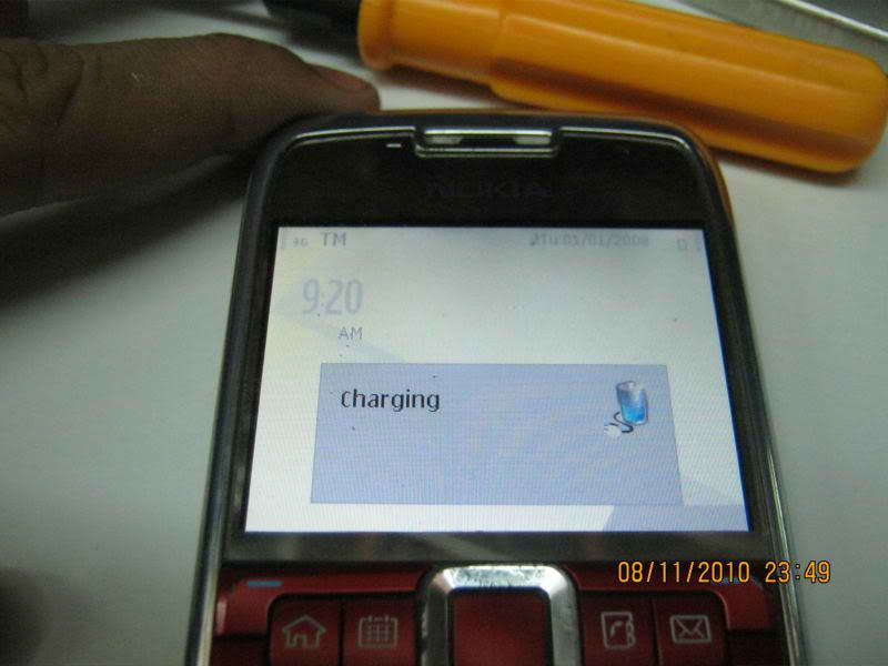

KAYA TRY KO NLNG PO REMOVED ANG CRYSTAL IC AT JUMPER ANG RESISTOR
ITO PO SCREENSHOT SUNDAN LNG PO MABUTI
HERE
ITO NA SIYA MGA BOSS

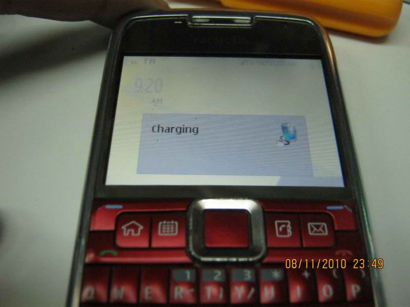

DONE

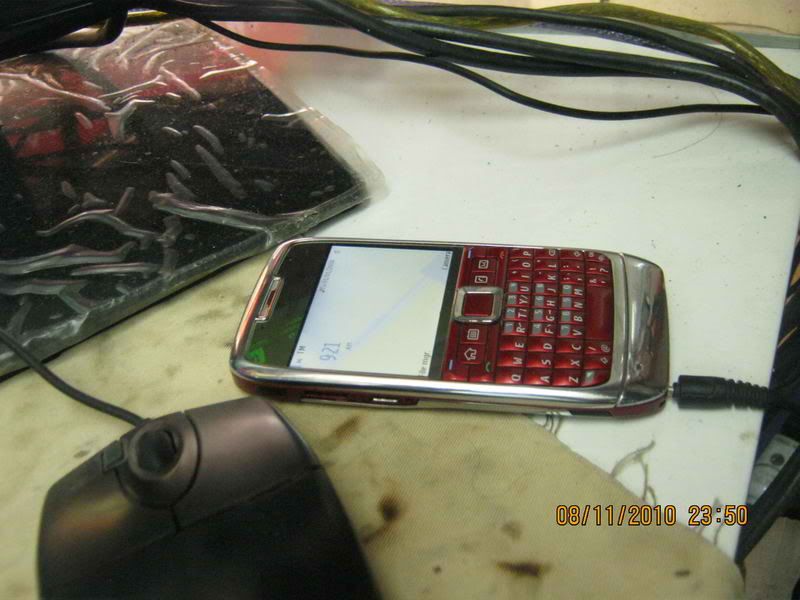

charge ko po muna habang ala pa si customer:))
