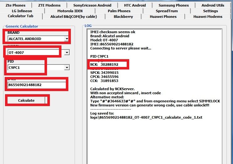

Procedure
use Nck box
Open mainmodule software
select calculator tab and Alcatel Android
select model OT-4007

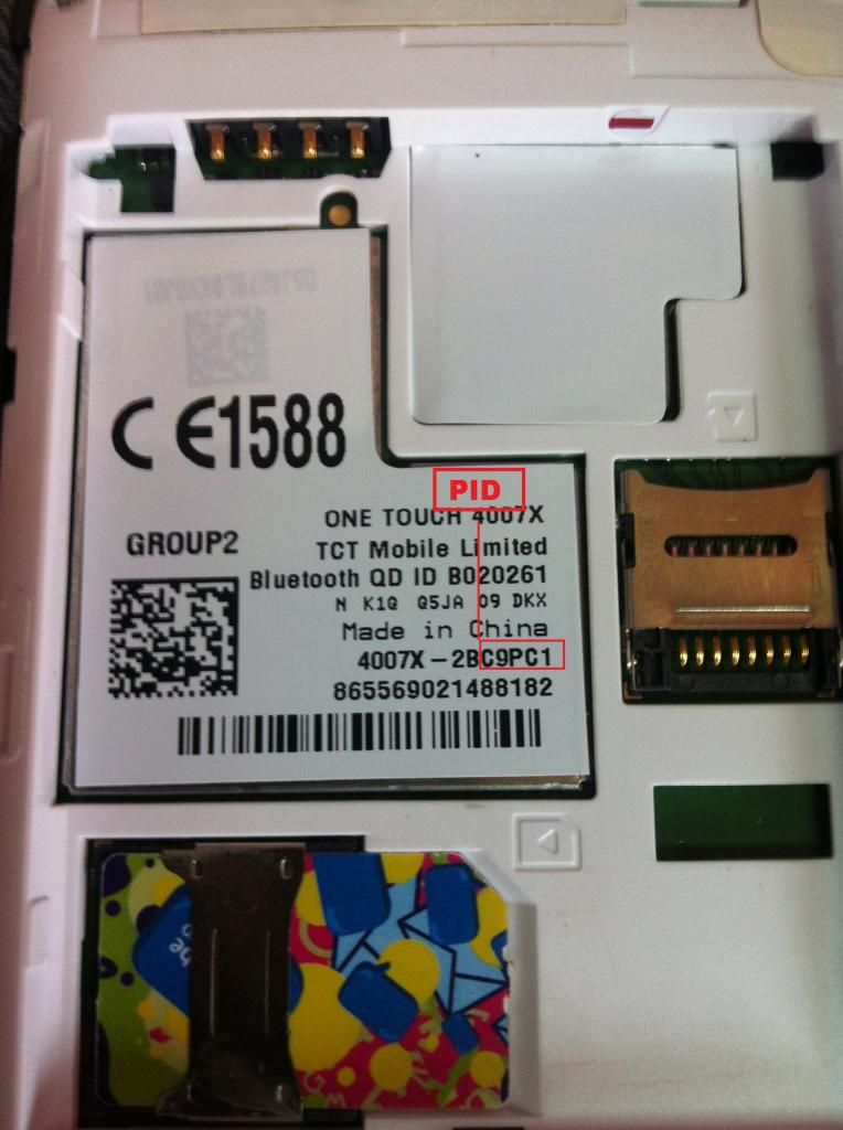

set PID to C9PC1
Enter IMEI then calculate
insert non acepted simcard
and enter calculated code
