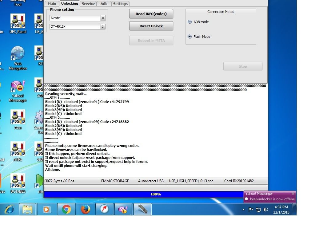

share ko lang itong unlocked ko this time alcatel model-ot4016x galing abroad humihingi ng unlocking code read info lang sa nck android tool success sya
procedure:
-open the nck android tool
-click the unlocking tab. choose the correct model
-then hit read info only
wait nyo lang lumabas yung mga code. then put to the phone manually
screen lang
procedure:
screen lang
