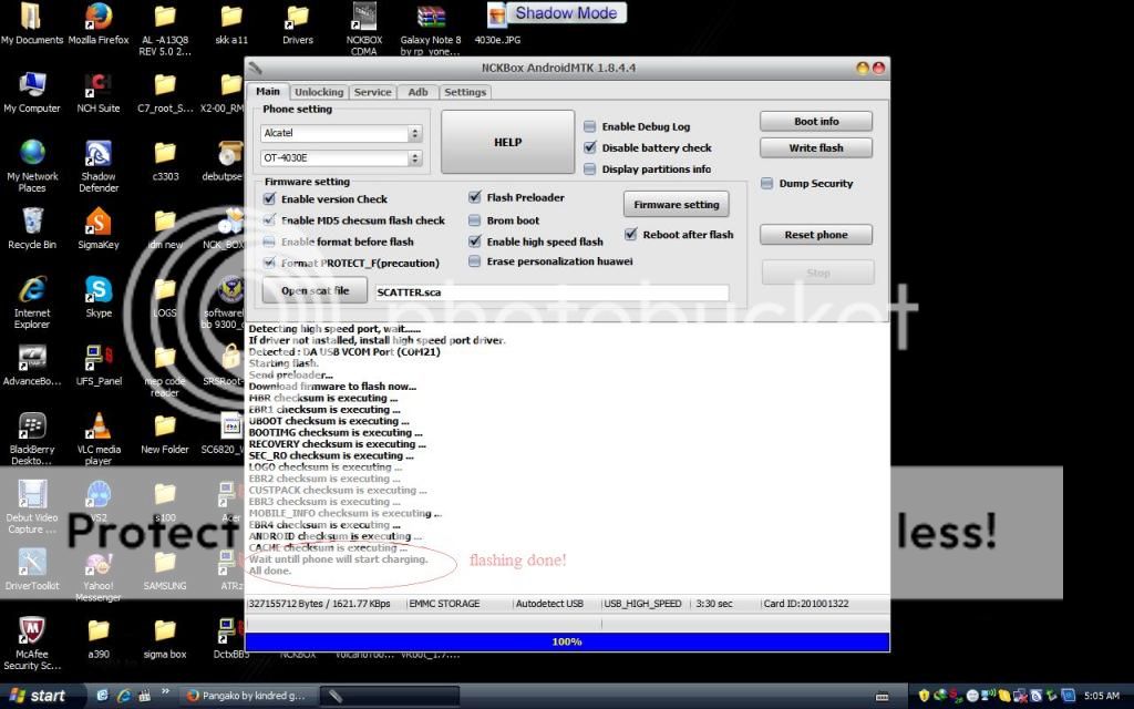

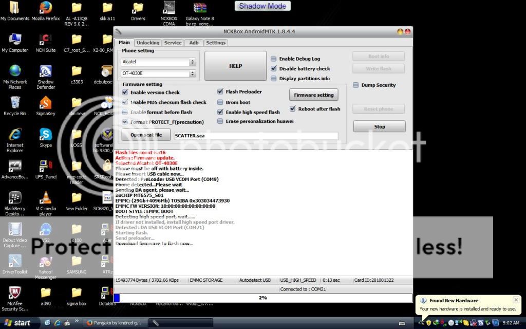

OT-4030e hang no hard reset done flashing nck
Download firmware in support site NCk
open Andriod mtk flasher (updated)
use micro usb 5130 cable
off cp then plug usb..
install drivers needed.
dont touch anything in settings
open scat file then hit write flash wait until done.
Detecting high speed port, wait......
If driver not installed, install high speed port driver.
Detected : DA USB VCOM Port (COM21)
Starting flash.
Send preloader...
Download firmware to flash now...
MBR checksum is executing ...
EBR1 checksum is executing ...
UBOOT checksum is executing ...
BOOTIMG checksum is executing ...
RECOVERY checksum is executing ...
SEC_RO checksum is executing ...
LOGO checksum is executing ...
EBR2 checksum is executing ...
CUSTPACK checksum is executing ...
EBR3 checksum is executing ...
MOBILE_INFO checksum is executing ...
EBR4 checksum is executing ...
ANDROID checksum is executing ...
CACHE checksum is executing ...
Wait untill phone will start charging.
All done.
smile na..
