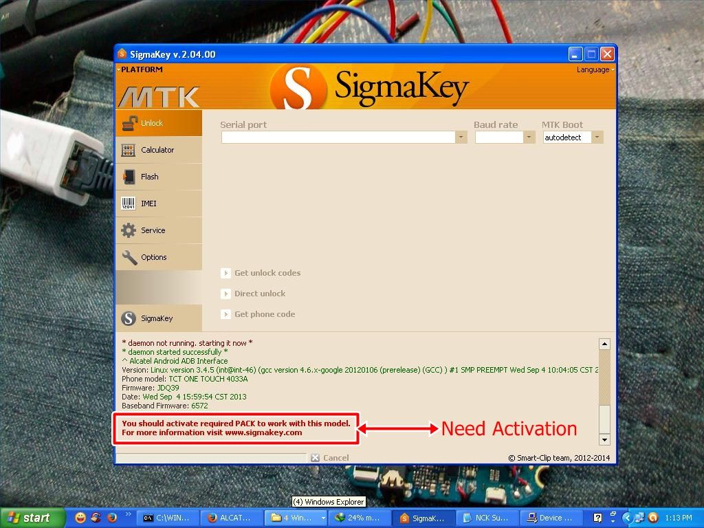

OT-4033 Unlock in Sigma Not done. NCK Dongle DONE
Problem
Network Smart only
Tools To Be Used
Nck Dongle Not Activated Wala pa pera pang activate
5310 usb cable
Action Taken
Root first before Unlocking

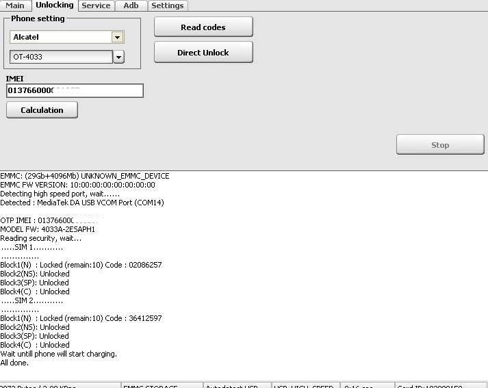

Open Gui NCKDongle_Android_MTK_Module_v2.4.6_Setup
select 4030
click Read codes
insert usb in power off
wait till Done
Not Done Need Activation
Done kahit di sya activated
