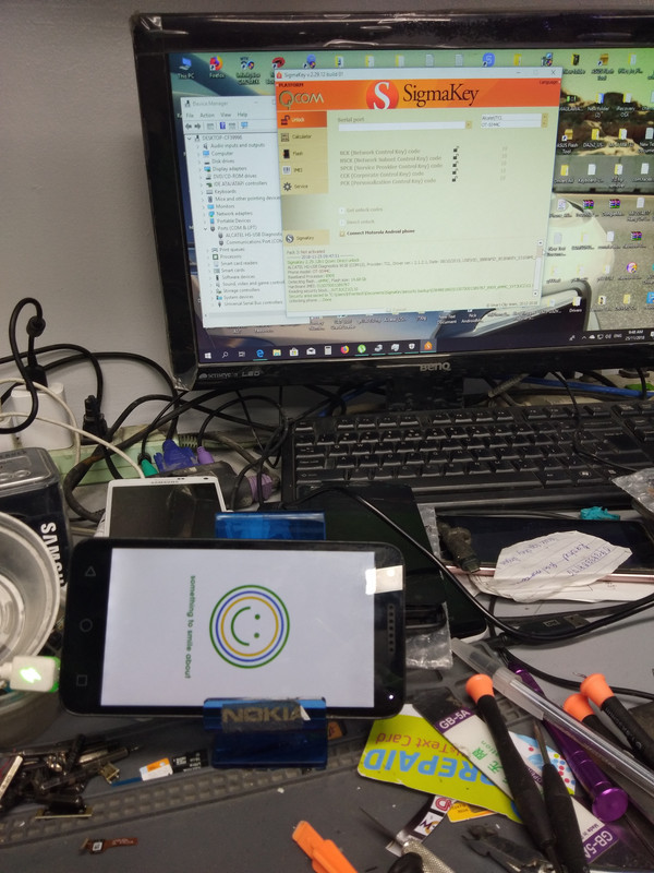

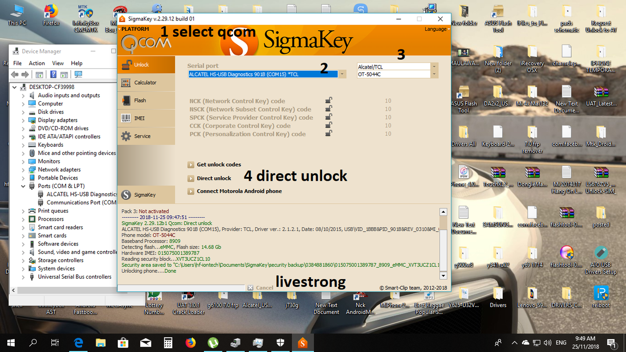

4.patayin ang unit na nakasaksak sa pc...
5.open si sigma...at tignan ang picture...
alam nio kasunod nyan...nasa picture na..
logs
SigmaKey v.2.29.12 build 01
384881860 Sigma dongle 2.29, Initializing...OK
Pack 1: Activated
Pack 2: Activated
Pack 3: Not activated
--------- 2018-11-25 09:47:51 ---------
SigmaKey 2.29.12b1 Qcom: Direct unlock
ALCATEL HS-USB Diagnostics 901B (COM15), Provider: TCL, Driver ver.: 2.1.2.1, Date: 08/10/2015, USB\VID_1BBB&PID_901B&REV_0310&MI_01
Phone model: OT-5044C
Baseband Processor: 8909
Detecting flash...eMMC, Flash size: 14.68 Gb
Hardware IMEI: 015075001389787
Reading security block...XVT3UCZ1CL10
Security area saved to "C:\Users\hf-iontech\Documents\SigmaKey\security backup\0384881860\015075001389787_8909_eMMC_XVT3UCZ1CL10.skb"
Unlocking phone....Done

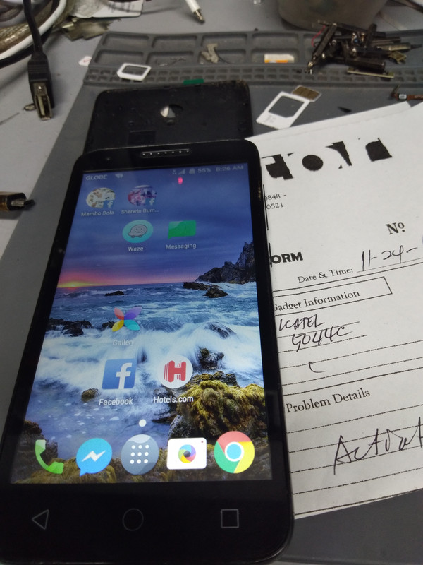

antayin mag kusang mag reboot..
finish product
