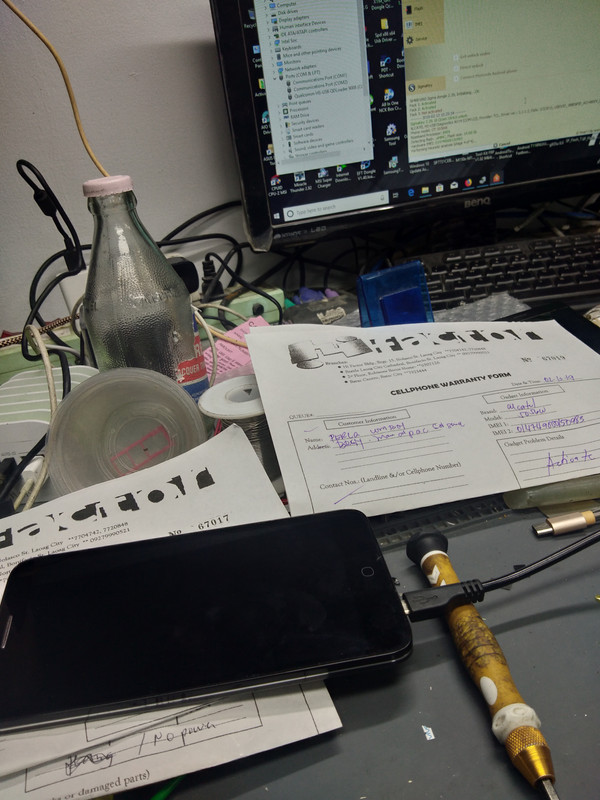

problem activated...
since di pumasa sa free na device unlock proceed kay sigma...
finish product

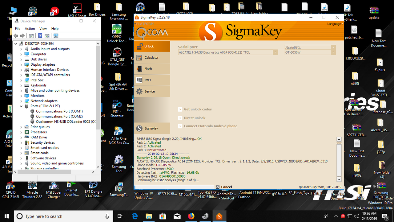

procedure install driver nasa phone yun or download here
dial this sa dial pad para diagnostic port
###2324#
if driver are all install power off the unit then saksak sa usb
wait to detect by sigma (see picture number 2 sa selecting port)

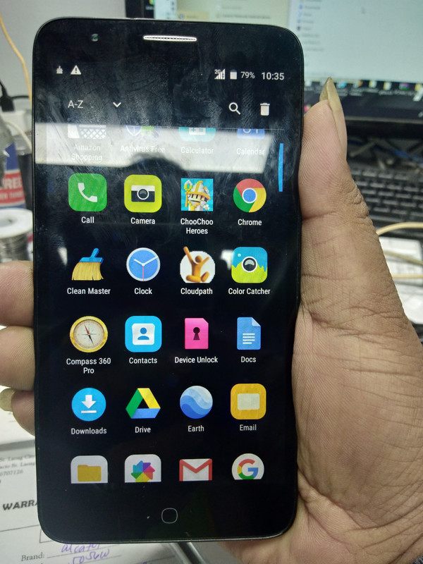

then do direct unlock wait till finish..
