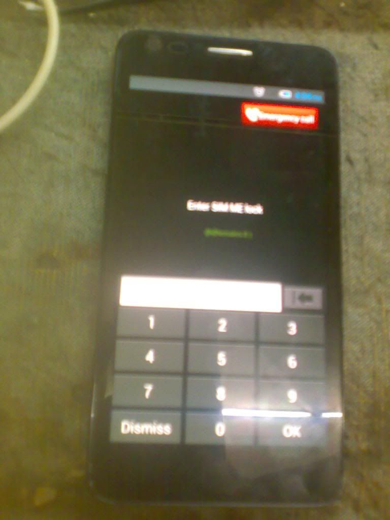

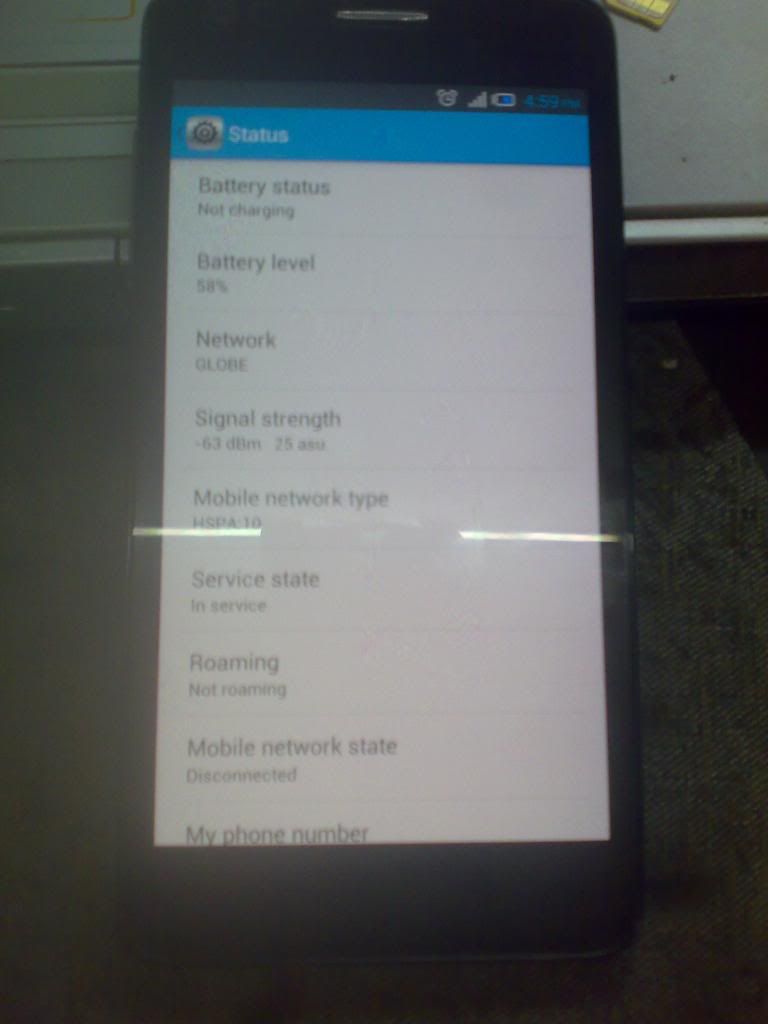

Alcatel OT 6033X Unlock done by NCK Dongle
Procedure:
Quote:
Open nck dongle alcatel android tool
select unlocking
choose correct model then do read codes for unlock
Press volume down then insert micro usb
wait until done.....

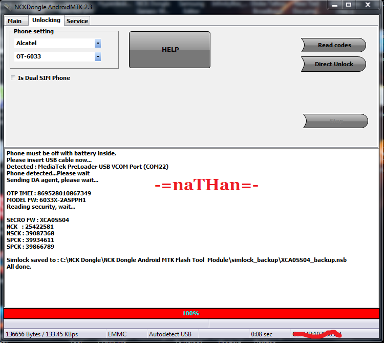

LOGS:
Quote:
Phone must be off with battery inside.
Please insert USB cable now...
Detected : MediaTek PreLoader USB VCOM Port (COM22)
Phone detected...Please wait
Sending DA agent, please wait...
OTP IMEI : 869528010867349
MODEL FW: 6033X-2ASPPH1
Reading security, wait...
SECRO FW : XCA0SS04
NCK : 25422581
NSCK : 39087368
SPCK : 39934611
SPCK : 39866789
Simlock saved to : C:\NCK Dongle\NCK Dongle Android MTK Flash Tool Module\simlock_backup\XCA0SS04_backup.nsb
All done.
