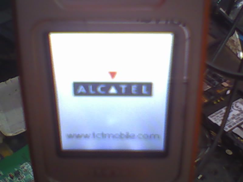

OT-C701 alcatel logo only DONE..[Reference]
PROBLEM:
LOGO ONLY WHEN POWER ON...

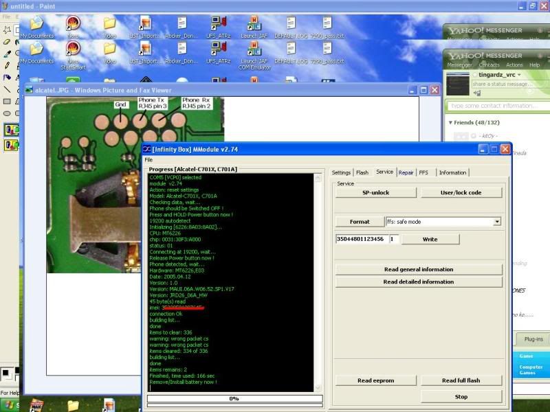

SOLUTION:
FORMAT FFS ONLY!!!!
PINOUT:
COM5 [VCP0] selected
module v2.74
Action: reset settings
Model: Alcatel-C701X, C701A
Checking data, wait...
Phone should be Switched OFF !
Press and HOLD Power button now !
19200 autodetect
Initializing [6226:8A03:8A02]...
CPU: MT6226
chip: 0031:30F3:A000
status: 01
Connecting at 19200, wait...
Release Power button now !
Phone detected, wait...
Hardware: MT6226,E03
Date: 2005.04.12
Version: 1.0
Version: MAUI.06A.W06.52.SP1.V17
Version: JRD26_06A_HW
45 byte(s) read
imei: 353tingardz_vrc
connection Ok
building list...
done
items to clear: 336
warning: wrong packet cs
items cleared: 334 of 336
building list...
done
items remains: 2
Finished, time used: 166 sec
Remove/Install battery now !
SOLUTION:
FORMAT FFS ONLY!!!!
PINOUT:
module v2.74
19200 autodetect
CPU: MT6226
status: 01
Date: 2005.04.12
Version: 1.0
45 byte(s) read
connection Ok
building list...
done
items to clear: 336
building list...
done
items remains: 2
