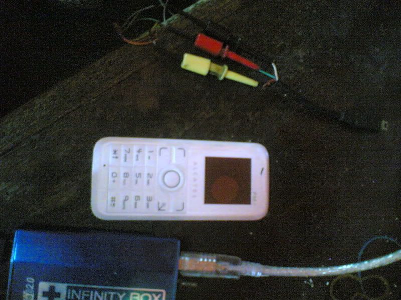

ot-s211 unlock done wit modify cable
share ko lng mga boss alcatel s211 unlock success with my modify cable na diipitCOM4 [VCP0] selected
module v1.38
Device: Alcatel-S211
"advanced chip detection" active
Action: unlock
Checking data, wait...
Boot ...
Phone should be Switched OFF !
Press Power button now !
rom version: 0502
Connecting...
booting...
finalizing...
Boot done
Check connection ...
Check connection done
Set baud ...
812500
Set baud done
Check hardware ...
flash: 012A7E2A242A00:54000000000000
flash: AMD/Fujitsu std [T 003Fx010000 0004x004000] 4Mb
Check hardware done
Read data ...
reading Alcatel-S211_eeprom_calibration-1...
file saved: C:\Program Files\InfinityBox\HModule\Alcatel-S211_eeprom_calibration-1_20100719-143613.80E.bin
Read data done
Check data ...
Check data done
Write ...
Write: simlock
Write done
Finished, time used: 8 min 33 sec
Remove/Install battery now !
ito pinout mga boss
modify /12345\
1: Gnd
3: box Tx/phone Rx (RJ45 pin-2)
4: box Rx/phone Tx (RJ45 pin-3)
