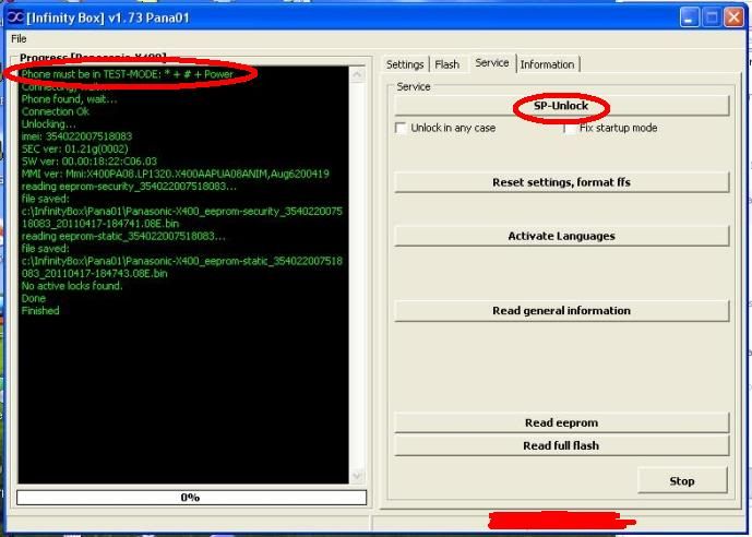

share ko lang po...
Panasonic X400 from Australia,locked sa optus,unlocked by Infinity...luma na pero pagkakakitaan pa...hehehe
-use t191 cable
-phone must be in boot mode...press *+#+ power
-open Infinity shell
-select panasonic
-select x400
-goto service tab
-tick "Sp-unlock"
-done
screenshots
unlocking

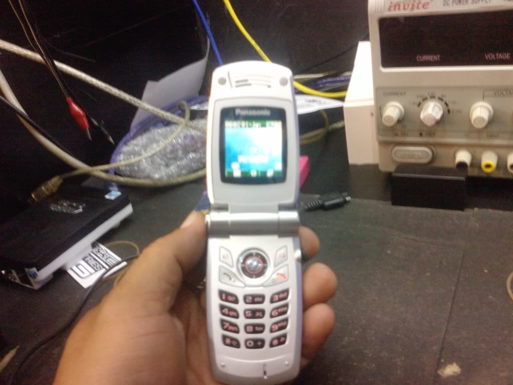

finish product
