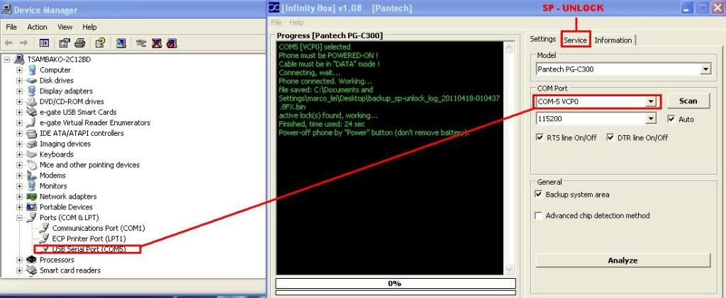

Procedure :
Open Infinity
Select Model
Insert Modified Cable Rx - Tx - GND
Phone must be POWERED-ON !
Cable must be in "DATA" mode !
COM5 [VCP0] selected
Connecting, wait...
Phone connected. Working...
file saved: C:\Documents and Settings\marco_lei\Desktop\backup_sp-unlock_log_20110418-010437.8FX.bin
active lock(s) found, working...
Finished, time used: 24 sec
Power-off phone by "Power" button (don't remove battery).

Procedure :
Open Infinity
Select Model
Connecting, wait...
