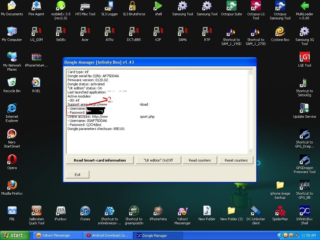

first read the username and password

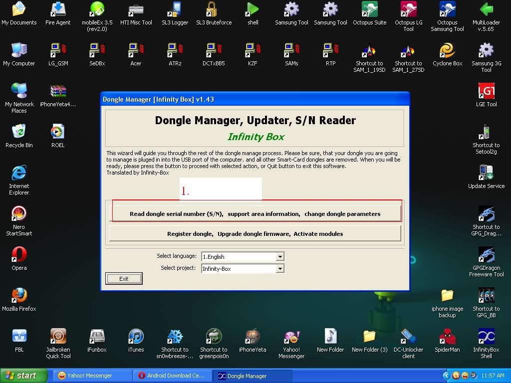

open infinity dongle manager
click read dongle serial s/n , support area information change dongle parameters
copy the username and password.,,,

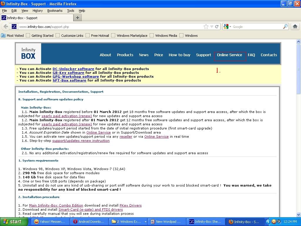

open infinity box shell
click support area
click enter support / download area
click online service

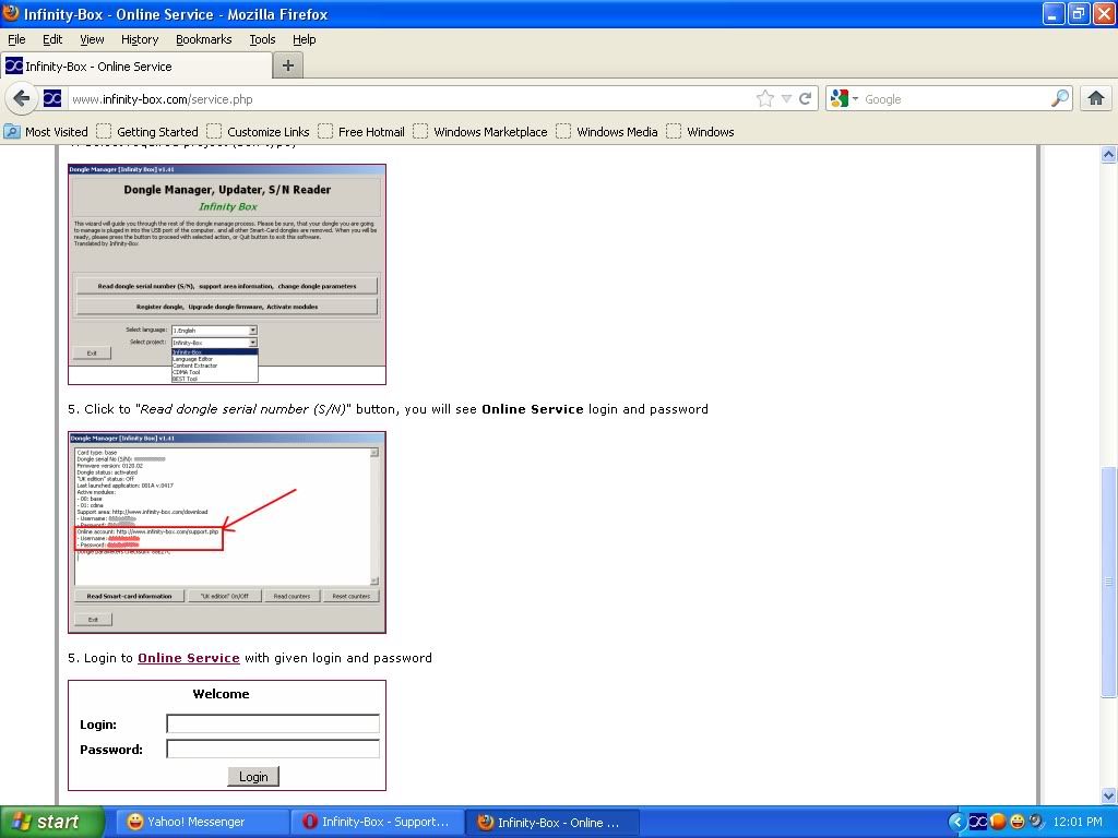

open online service
log in your acount
click products and addons
click all products
scroll down select phone brand
click get it
select phone model
type imei or serial number of the phone
click get codes
wait until finish

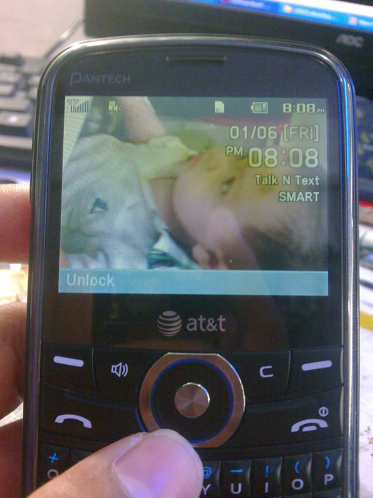

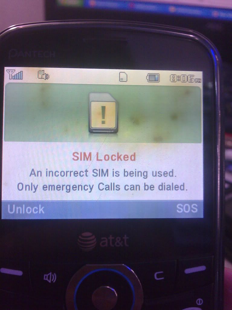

when you see the code

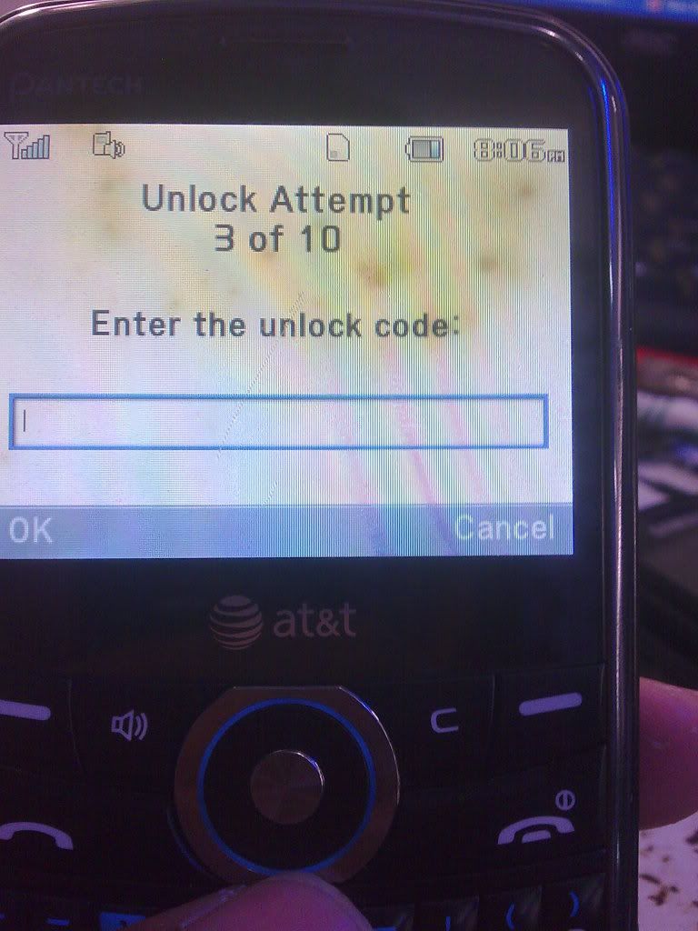

put non accepted sim card the phone

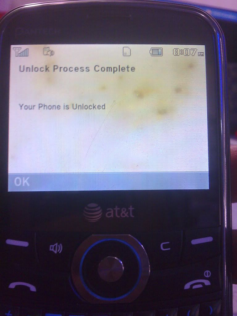

power on then enter the unlock code....
price: 0
operation: Pantech
imei: 012141003738729
comment: PANTECH P7040 Link - 012141003738729
status: done
code 1: 97420692​
