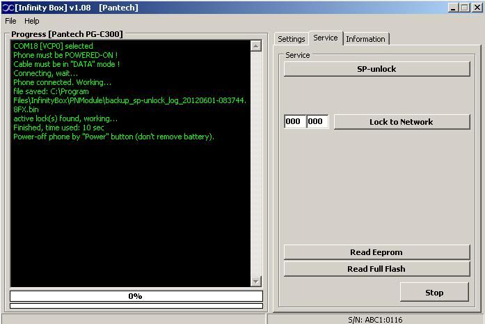

Pantech C300 openline
Pinout:
keboard up -> count connector pins 1 to 24 from left to rigth.
10: Phone Rx (RJ-45 pin-2)
11: Phone Tx (RJ-45 pin-3)
24: Gnd
unlocking:
- power on and connect to your infinity box
- open shell -> select model -> goto service and tick Sp-Unlock
