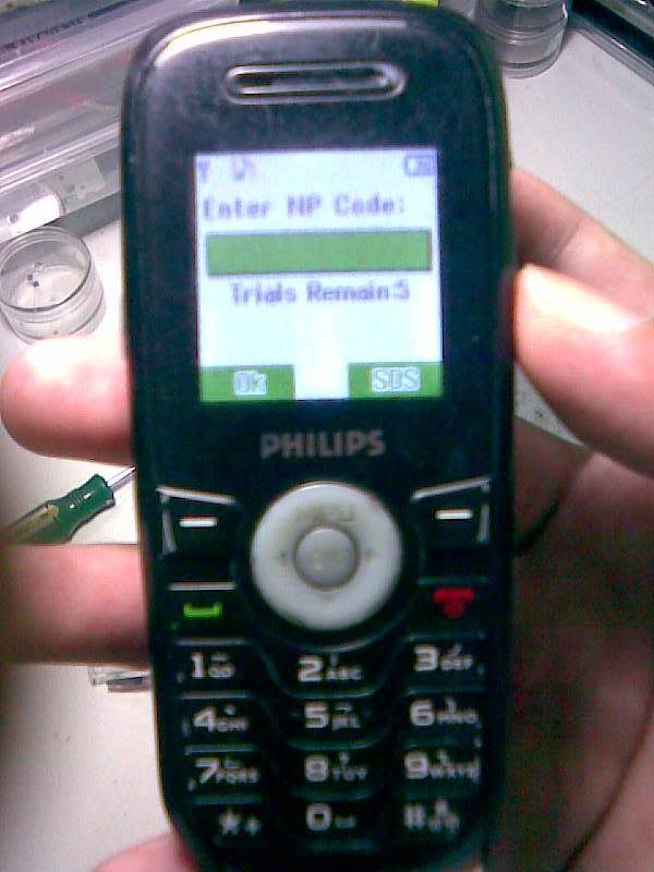

Procedure:
1. Insert None Accepted Sim Card
2. Then Enter this Code ( 30109591 )
put any sim > enter code

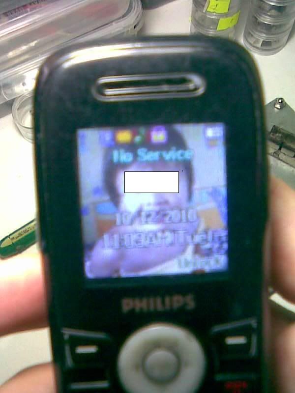

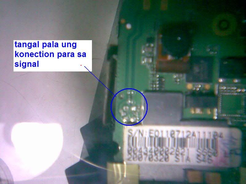

Sucess............ kaso No Signal naman ang unit
kaya pala tangal na ung konection para sa signal
jumper capasitor

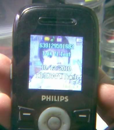

after jumper balik lang natin......ayos!
