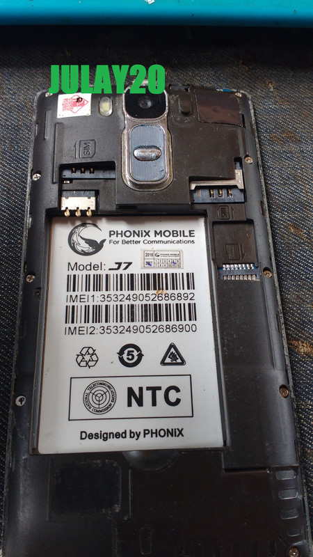

History:
nakalimotan ni tumer yung password
dahil wala itong recovery mode
patangal daw nya yung password

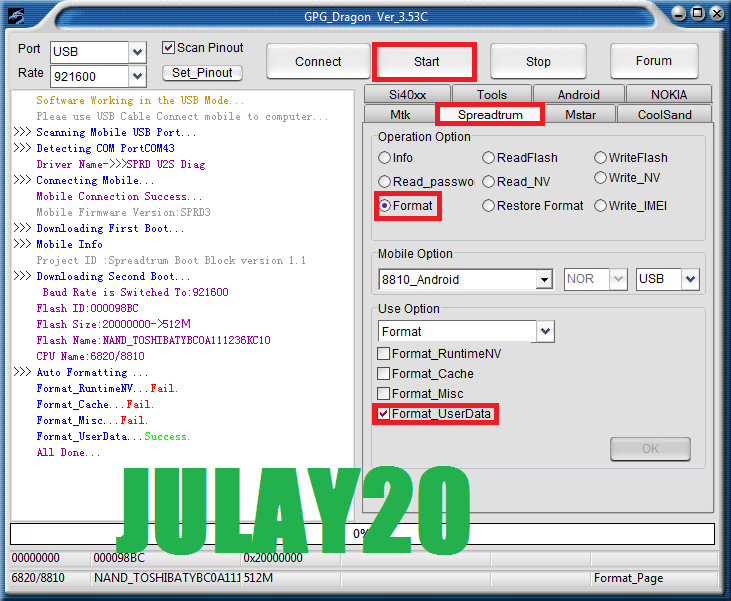

Procedure:
open GPG Dragon crack
click spreadtrum
select format
chick format userdata
hit start button
Hold voll up
saksak usb antayin mo lang mag done :D
picture:
LOG'S
Code:
    Software Working in the USB Mode...
    Pleae use USB Cable Connect mobile to computer...
>>> Scanning Mobile USB Port...
>>> Detecting COM PortCOM43
    Driver Name->>>SPRD U2S Diag
>>> Connecting Mobile...
    Mobile Connection Success...
    Mobile Firmware Version:SPRD3
>>> Downloading First Boot...
>>> Mobile Info
    Project ID :Spreadtrum Boot Block version 1.1
>>> Downloading Second Boot...
     Baud Rate is Switched To:921600
    Flash ID:000098BC
    Flash Size:20000000->512M
    Flash Name:NAND_TOSHIBATYBC0A111236KC10
    CPU Name:6820/8810
>>> Auto Formatting ...
    Format_RuntimeNV...Fail.
    Format_Cache...Fail.
    Format_Misc...Fail.
    Format_UserData...Success.
    All Done...
Donee:D
