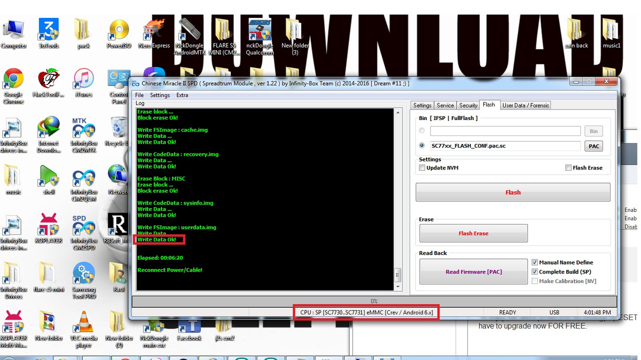

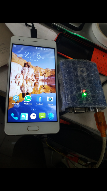

PHONIX MOBILE TUPITER HANG LOGO DONE tested firmware CM2
3
280
283
raul_king123
Aug 5, 2015
65
Port Opened
Sync...
InitBoot Done [ 0x81 ] , Ver : SPRD3
Sync...
Sending FDL
[Info] : If SW freeze here more, than 15 seconds - remove cable
FDL Ready!
Boot Ver : SC7731 Crev eMMC Loader v2.0
Sending FLASH FDL
FLASH FDL Ready!
Boot Ok!
FlashMode Set : Ok!
PMTManager : Load 0x21 records
PMTManager : PMT Update Ok!
Flashing now
Update BootCode : u-boot-spl-16k.bin
Write Data ...
Write Data Ok!
Update BootCode : u-boot.bin
Erase block ...
Block erase Ok!
Write Data ...
Write Data Ok!
Write FSImage : prodnv.img
Write Data ...
Write Data Ok!
Write CodeData : sc7731C_CP0_modem.bin
Write Data ...
Write Data Ok!
Write CodeData : DSP_DM_Gx.bin
Write Data ...
Write Data Ok!
Erase Block : RuntimeData
Erase block ...
Block erase Ok!
Write CodeData : sc8830g_modem_CP2_WCN_Trunk_W16.28.5_Release.bin
Write Data ...
Write Data Ok!
Write CodeData : logo_720x1280.bin
Write Data ...
Write Data Ok!
Write CodeData : logo2.bin
Write Data ...
Write Data Ok!
Write CodeData : logo3.bin
Write Data ...
Write Data Ok!
Write CodeData : logo4.bin
Write Data ...
Write Data Ok!
Write CodeData : logo5.bin
Write Data ...
Write Data Ok!
Write CodeData : logo6.bin
Write Data ...
Write Data Ok!
Write CodeData : logo7.bin
Write Data ...
Write Data Ok!
Write CodeData : logo8.bin
Write Data ...
Write Data Ok!
Write CodeData : logo9.bin
Write Data ...
Write Data Ok!
Write CodeData : logo10.bin
Write Data ...
Write Data Ok!
Write CodeData : boot.img
Write Data ...
Write Data Ok!
Write FSImage : system.img
Write Data ...
Write Data Ok!
Erase Block : PERSIST
Erase block ...
Block erase Ok!
Write FSImage : cache.img
Write Data ...
Write Data Ok!
Write CodeData : recovery.img
Write Data ...
Write Data Ok!
Erase Block : MISC
Erase block ...
Block erase Ok!
Write CodeData : sysinfo.img
Write Data ...
Write Data Ok!
Write FSImage : userdata.img
Write Data ...
Write Data Ok!
Elapsed: 00:06:20
