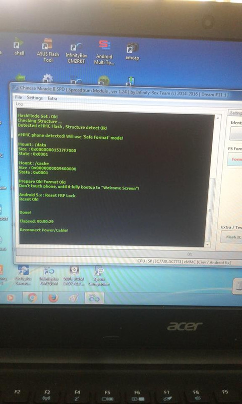

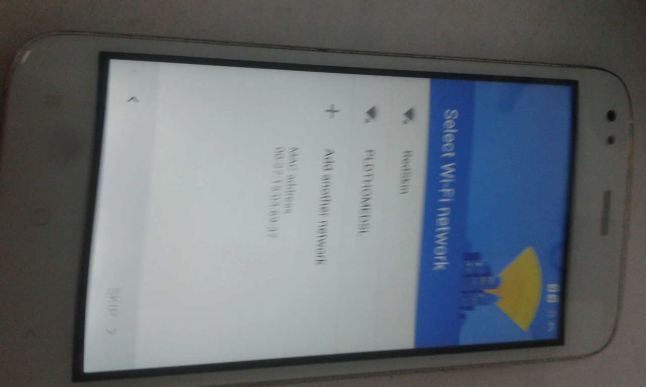

share ko lang gawa ko mga boss ito sya nang dala ni tomer
tira agad kay cm2 spd
tool:
cm2 spd ver 1.27
procedure:
open cm2 spd downloa >>>HERE<<<
settings min CPU SP [sc773x ] emmc [andriod 6.x]
go to service fs format/repair
click format fs / reset phone / clear frp
saksak usb hold voll up sa boot key pag na ok na driver bitaw voll up
wait... mag done
done sana mka tulong
