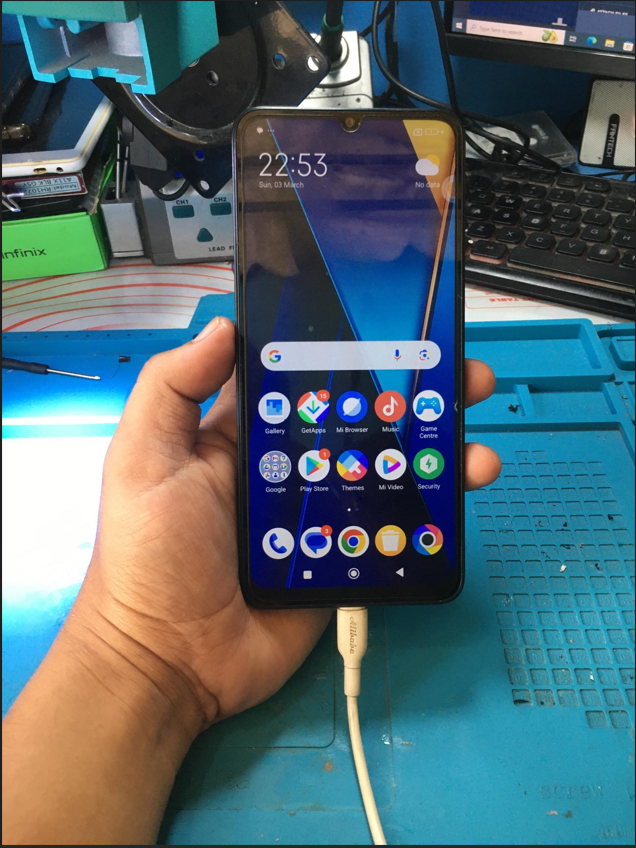

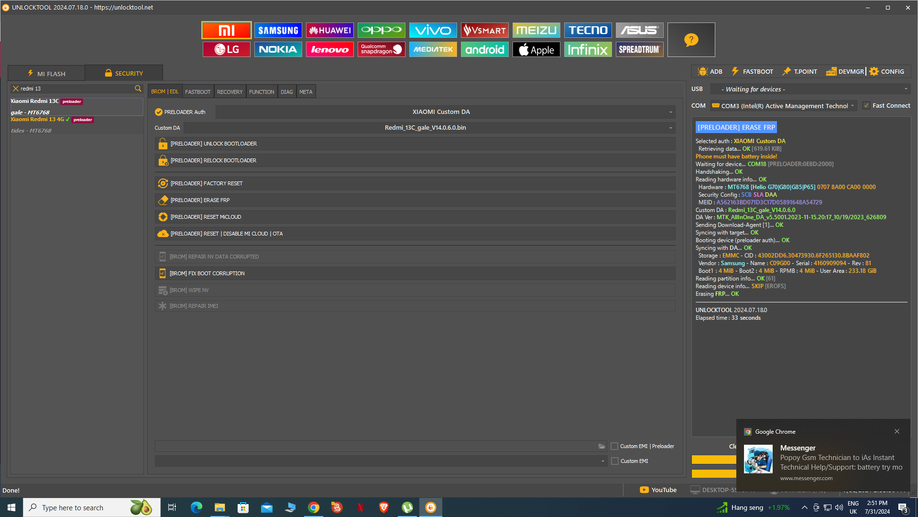

share ko lang mga master c65 frp problem via ut
ACTION TAKEN:
OPEN UT
MI TAB
SELECT UNIT REDMI 13C
CHECK PRELOADER AUTH
SELECT XIAMIO CUSTOM DA
CHOOSE REDMI 13C GALE
CLICK ERASE FRP THEN BOOTKEY
PAKI FOLLW NALANG PO ANG NASA PIC
