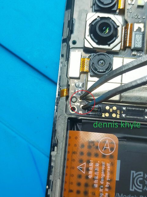

baklas ang unit para sa test point

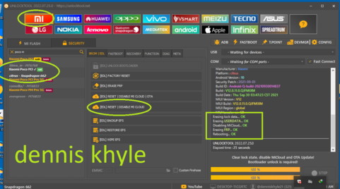

Open Unlock Tool.
Select mi ,Click Security Tab.
i type Poco M3 , search box then click Xiaomi Poco M3.
i testpoint ang unit Click [edl] Reset I DISABLE MI CLOUD.
wait mag done

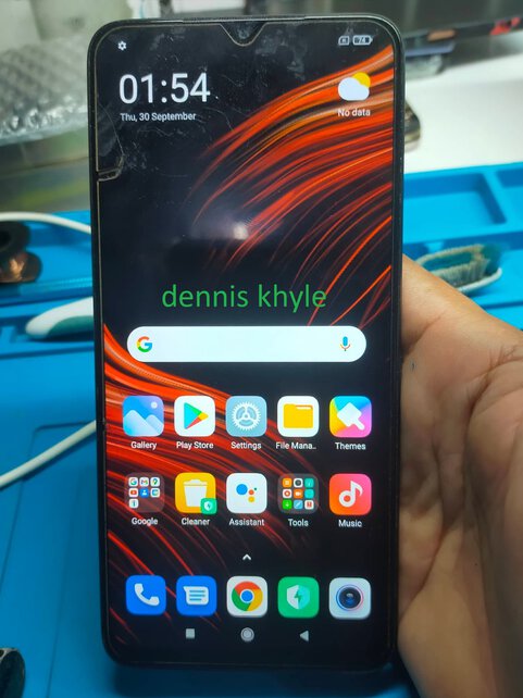

AYUS, sanay maka tulong po
