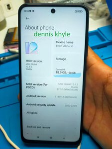

REFERENCE POCO M3 PRO 5G mi account remove ,done

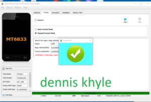

open sp tool,select format,click manual format, i copy ang format address sa begin address at format lenght

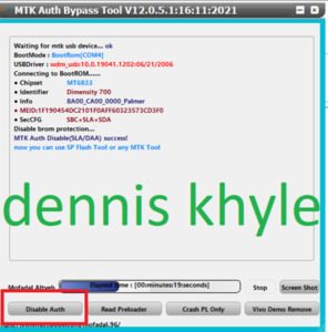

open mtk auth bypass tool,i off ang unit ,press ng sabay ang volume up and down at i click ang disable auth
press start ,wait mag format ok

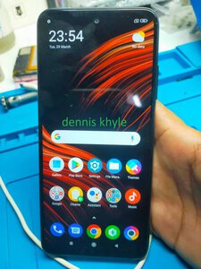

yun,
ok na, salamat sanay maka tulong po
