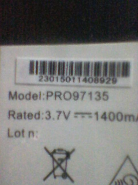

MODEL: POLAROID PRO97135
PROBLEM: SA SMART AT SUN LANG GUMAGANA..
ACTION: UNLOCK USING NCK BOX

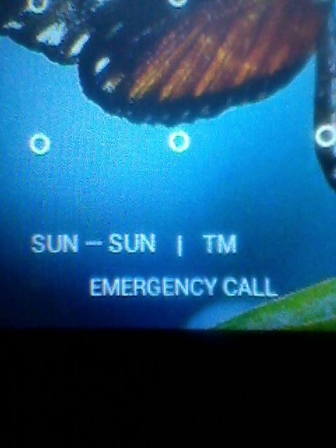

HISTORY:
SA SUN AT SMART LANG GUMAGANA
PAG TM NETWORK LOCKED LUMALABAS ..
WALA PO KASI KAMING SIGMA BOX KAYA SINUBUKAN KO SA NCK BOX
NAKA TYAMBA NAMAN..

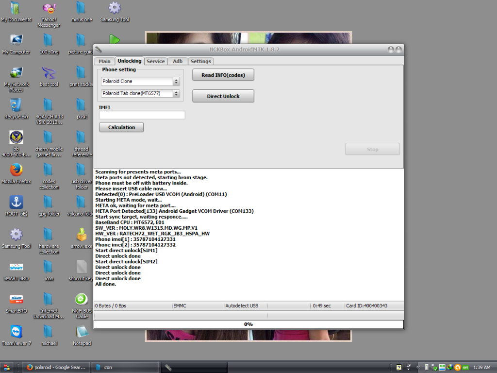

PROCEDURE:
1. OPEN NCK ANDROID MTK TOOL
2. CLICK UNLOCKING TAB
3. CHOOSE POLAROID CLONE
4. HIT DIRECT UNLOCK
5. POWER OFF THE PHONE
6. TANGGALIN AT IBALIK ANG BATTERY
7. SALPAK NG USB
SCREENSHOT:
FINISH PRODUCT:
