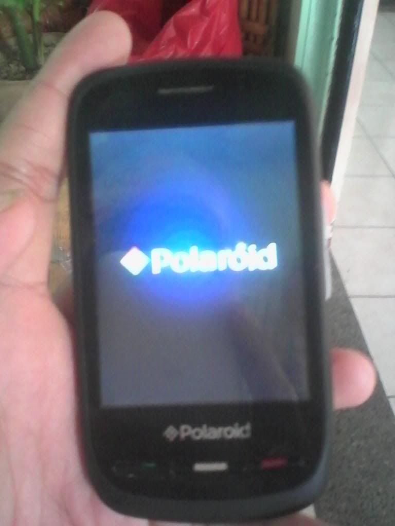

history bigla nalang daw eh!
UNIT screen shot:

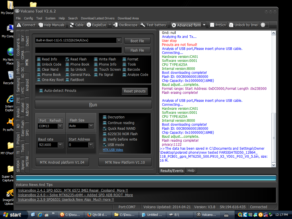

ito screen shot
format screenshot
after click auto format click yes molang!
screen shot for done
screen shot nman yung bagong backup nya!
sa backup naman uploading palang ako bagal ng net eh!

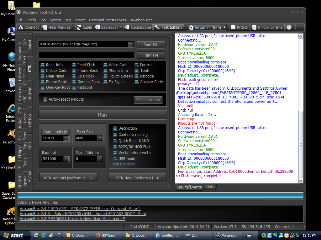

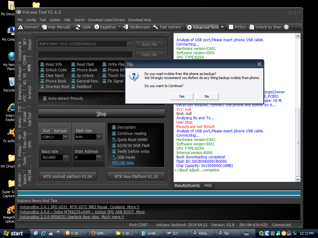

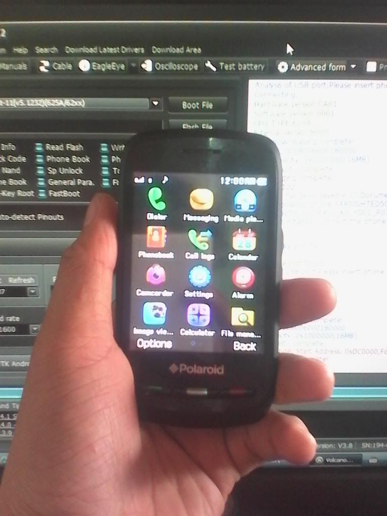

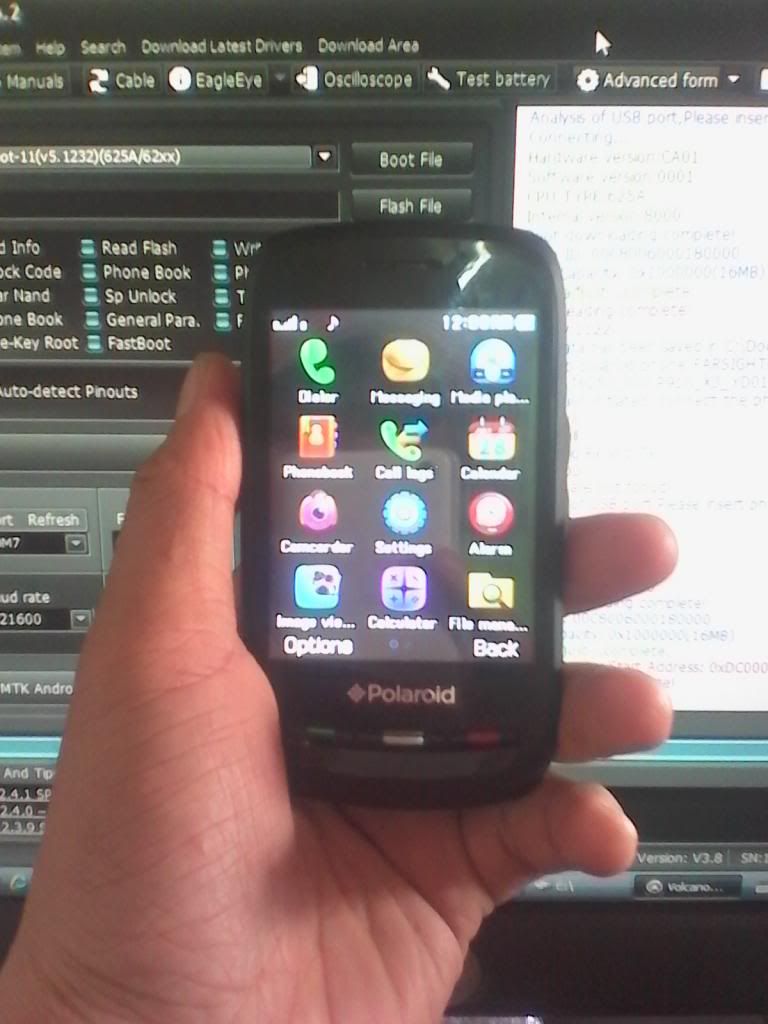

wait mo lalabas pag piliin auto format lang click mo!
ito screen shot
format screenshot
