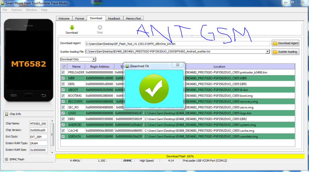

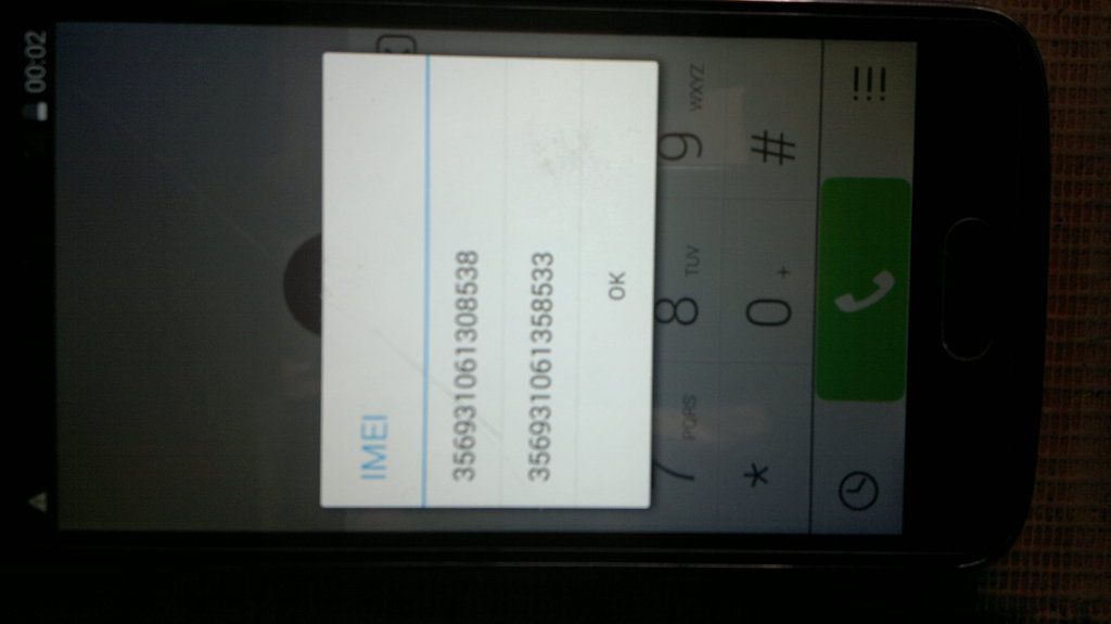

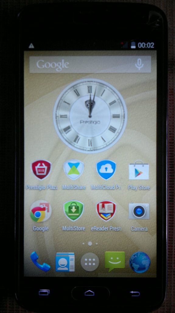

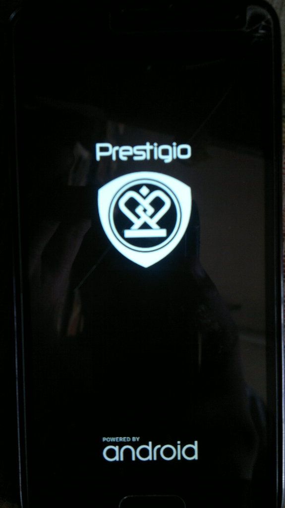

Prestigio PSP3502DUO hang on logo
mdyo mahirap hanapan ng firmware
wla ko mkuha dito s tahanan
pero kakahukay may nakuha din
dito pasok tested ko yan
http://www.needrom.com/download/prestigio-psp3502duo-stock/
hint..
extact file

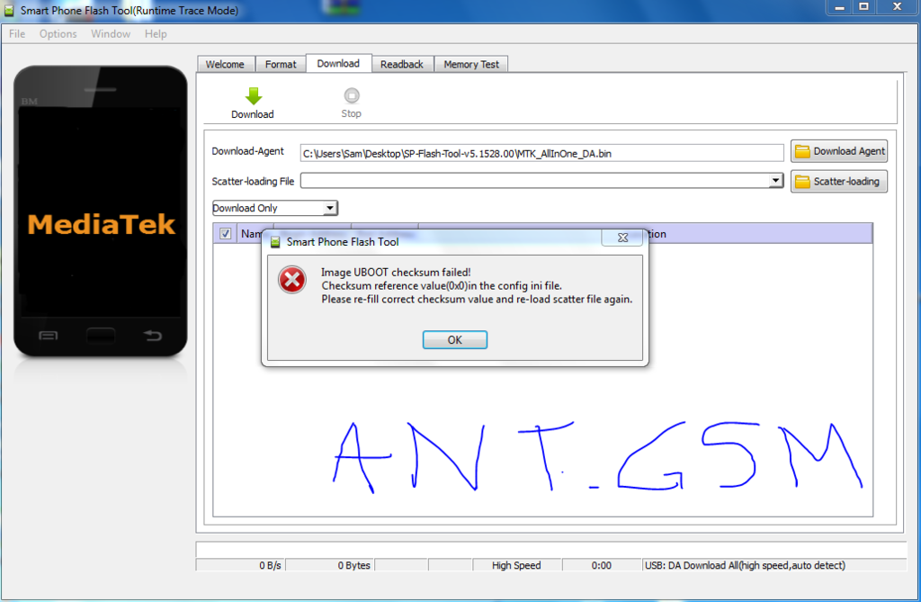

then delete nio muna to checksum dahil ganito lalabas pag di dinelete ung checksum file

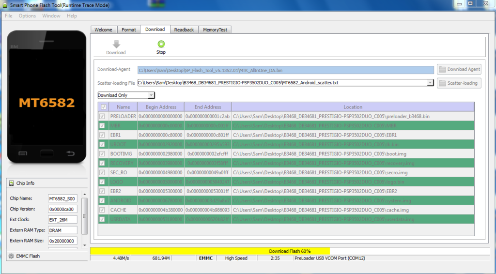

then balik n s spft
open spft
then load n scatter file
ok n flashing na
done na
for refference hope mktulong sating lahat
