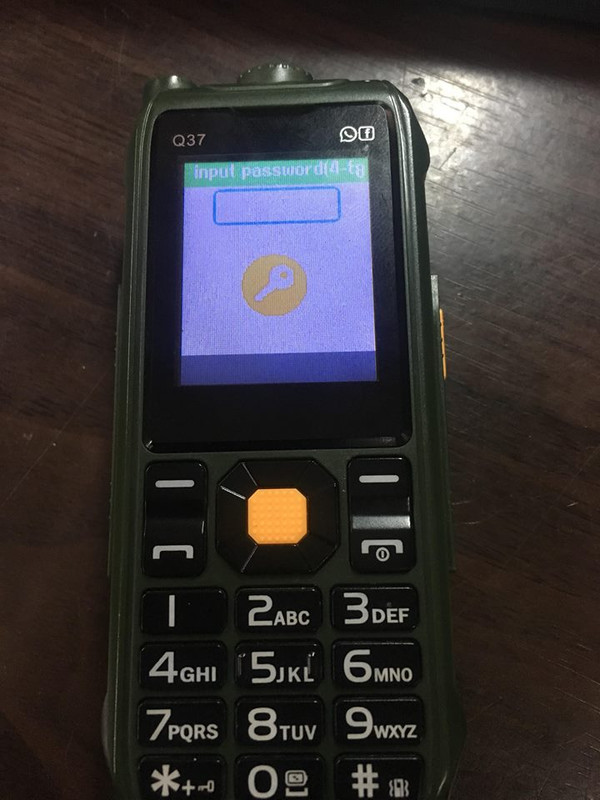

Card found : 79A76B2D , v0137
Infinity-Box Chinese Miracle II : SC/RDA Module [SCR] v1.03
SCRD mode : AUTO
SPRD mode : SC6530 : REV : 0000 : NOR
SPRD mode : SC6531 : REV : 0000 : NOR
Operation : Read UserCode [ v1.03 ]
MODE : From Device
1. Power off device
2. Press and hold BootKey or use BootCable
3. Insert cable and battery in device!
Wait for device ...
Device Connected!
BootVersion : SPRD3
BootSource : InternalLibrary
ERROR : FDL NOT started!
Error : Loader send failed!
Wrong model selected! Select correct one!
Reconnect Power/Cable!
SPRD mode : SC6531 : REV : E000 : NOR
MODE : From Device
1. Power off device
Wait for device ...
Device Connected!
BootVersion : SPRD3
BootVersion : Infinity SCR SC6531E Loader v 1.2
Port speed : 921600
FDL Flash : Control transfered!
Boot Done!
CS0_MEM : SPI : [WINBOND] : W25Q32 : 0x00400000 [ 4MiB ]
Reading data ...
Sorting data ...
STATE : ACTIVE : CODE : 1998
Done!
Elapsed: 00:00:19
AYAW PAAWAT MAY ARI 400 DONE
