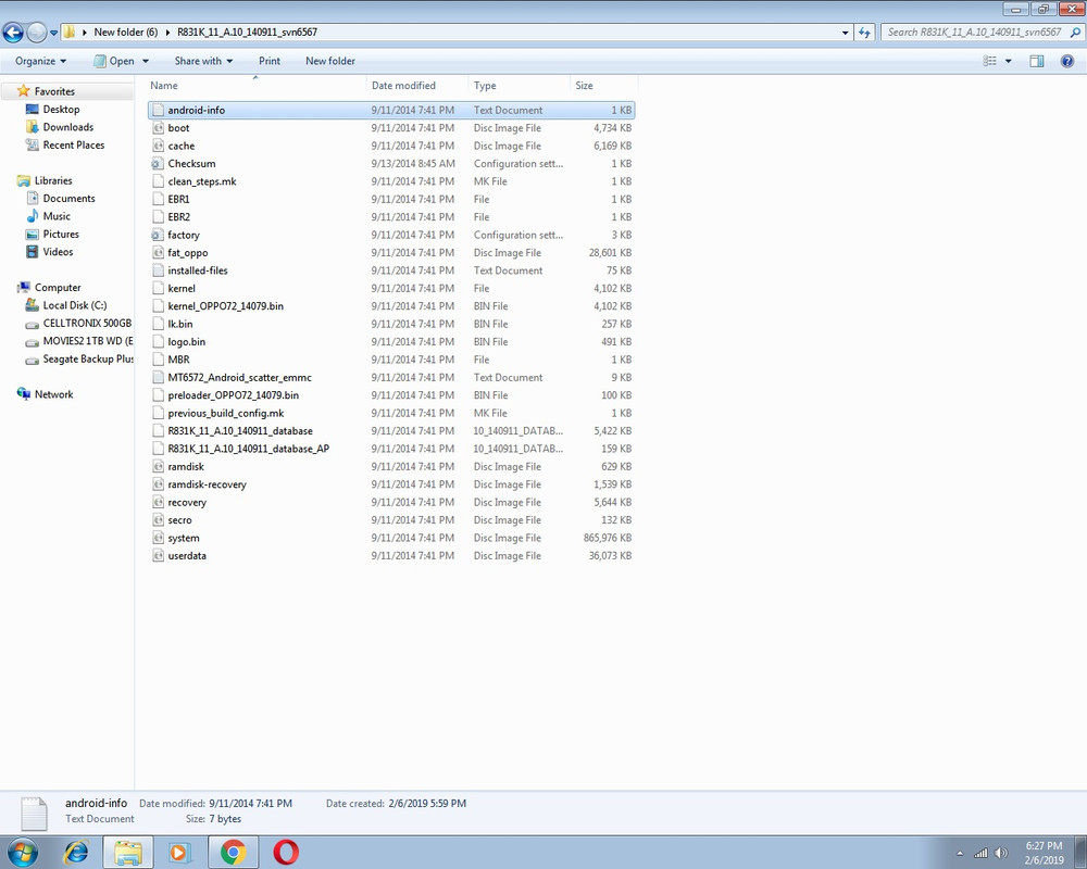

Code:
[COLOR="Lime"]Wait for phone...
Phone found! [ 3 ]
Sync...
Inital Boot Ok!
BB_CPU_PID : 6572
BB_CPU_NME : [MediaTek] MT6572_S00
BB_CPU_EXT : 0xCA01 , 0x8A00 , 0x0000
Processing BROM stage
Settings for BROM configured!
SecCfgVal : 0x00000000
BromVer : 0x0005
BLVersion : 0x00FE
PreLoader : NOT Active [ Erased ]
Processing DA stage
DA Select done, will use MTK_AllInOne_DA_v5.1624.16.07
Sending and initialize DA ...
Running DA ver.4.2 on BBID : 0x88
NAND Flash : NOT INSTALLED
eMMC Flash : 90014A4834473164040502A1FC3481F9
Initialize Memory ...
DRAM configured from ScatFW!
DRAM initialize passed!
DRAM size : 0x40000000
DAgent sent , init HW now
eMMC FlashIC initialized
[eMMC] : FLASH_VEN : 0x90 , OEM : 014A
[eMMC] : FLASH_INF : [HYNIX] , d1G4
[eMMC] : FLASH_CID : 90014A4834473164040502A1FC3481F9
[eMMC] : FLASH_BRT : 0x00400000 , 0x00400000 , 0x00400000
[eMMC] : FLASH_LEN : 0x00000000E9000000
[eMMC] : FLASH_UCP : 3728 MiB [eMMC 4 GiB]
DEV RID : 0x510A13BDDA75BE072D49187CF50354BD
INT RAM : 0x00020000
EXT RAM : 0x40000000 [1 GiB]
BOOT TYPE : EMMC_FLASH_BOOT
SOC VERIFY : C1
Boot Ok!
ScatCFG : BaseBand : MT6572 , Project : OPPO72_14079 , Storage : EMMC
Setting : Flash Pre-Erase (Safe) : Enabled
Setting : AFF verify : Enabled
Setting : HW verify : Enabled
Switching to HSUSB
HSUSB Init Ok
BL : Check HW compatibility
BL : BBID supported by BootLoader!
BL : Check eMMC compatibility
BL : eMMC supported by BootLoader!
BL : BatteryLevel : 4228 mV
BL : BatteryLevel Ok
BL : Flash Pre-Erase
Total blocks to Erase : 4
Erase : 0x0000000000C00000-0x0000000000100000
Erase : 0x0000000002900000-0x0000000001A80000
Erase : 0x0000000004480000-0x0000000002000000
Erase : 0x0000000007480000-0x0000000080900000
Flash Pre-Erase Done, time used : 00:00:04
SecCfg Passed , 1799
BMT remark not need. Will skip
Sending Preloader ...
Use : preloader_OPPO72_14079.bin
Preloader Sent , Init passed
PartCount : 0017
Update PMT by user request
Repartition Done!
Use FLN Mode
Processing : Flash Write
Flash now : MBR
Image Flash Ok
Flash now : EBR1
Image Flash Ok
Flash now : UBOOT
Image Flash Ok
Flash now : BOOTIMG
Image Flash Ok
Flash now : RECOVERY
Image Flash Ok
Flash now : SEC_RO
Image Flash Ok
Flash now : LOGO
Image Flash Ok
Flash now : EBR2
Image Flash Ok
Flash now : ANDROID
Image Flash Ok
Flash now : CACHE
Image Flash Ok
Flash now : USRDATA
Image Flash Ok
Flash now : FAT
Image Flash Ok
Flash Write Done, time used : 00:03:40
Processing : Verify
Verify Passed : MBR
Verify Passed : EBR1
Verify Passed : UBOOT
Verify Passed : BOOTIMG
Verify Passed : RECOVERY
Verify Passed : SEC_RO
Verify Passed : LOGO
Verify Passed : EBR2
Verify Passed : ANDROID
Verify Passed : CACHE
Verify Passed : USRDATA
Verify Passed : FAT
Data Verify Done, time used : 00:00:04[/COLOR]
