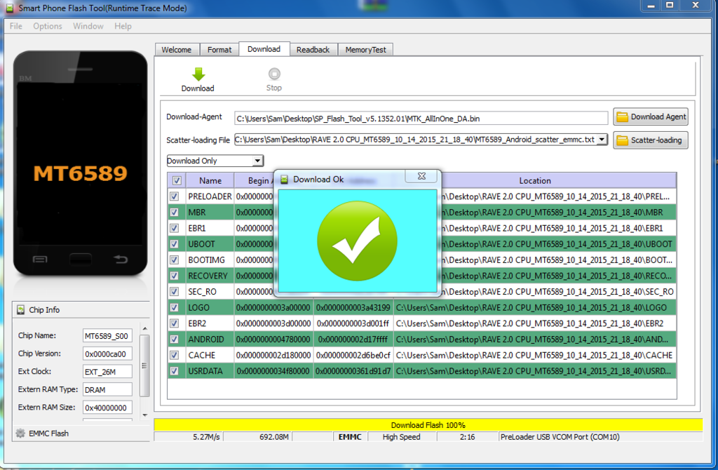

rave 2.0 hang on logo done with tested scatter file back up

eto naman po back up ko ulit
scatter file dito for spft back up from merapi
http://www.mediafire.com/download/yqv24phhao47kjb/rave_2.0_tested.rar
procedure
open spft
load firmware scatter file
click download
salpak lng usb
wait lang mag complete
hard reset after flash
for reference only thanks
