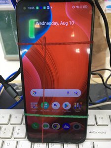

REFERENCE realme 7i rmx2103 frp done via unlocktool

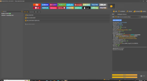

dial *#812# and *#813# not working for removing frp
run unlocktool latest version
select oppo
select realme 7i (2020) rmx2103
select brom/edl
click (edl) erase frp
phone in off mode, hold vol- and vol+ then connect usb cable to pc
detection is auto
wait till done
