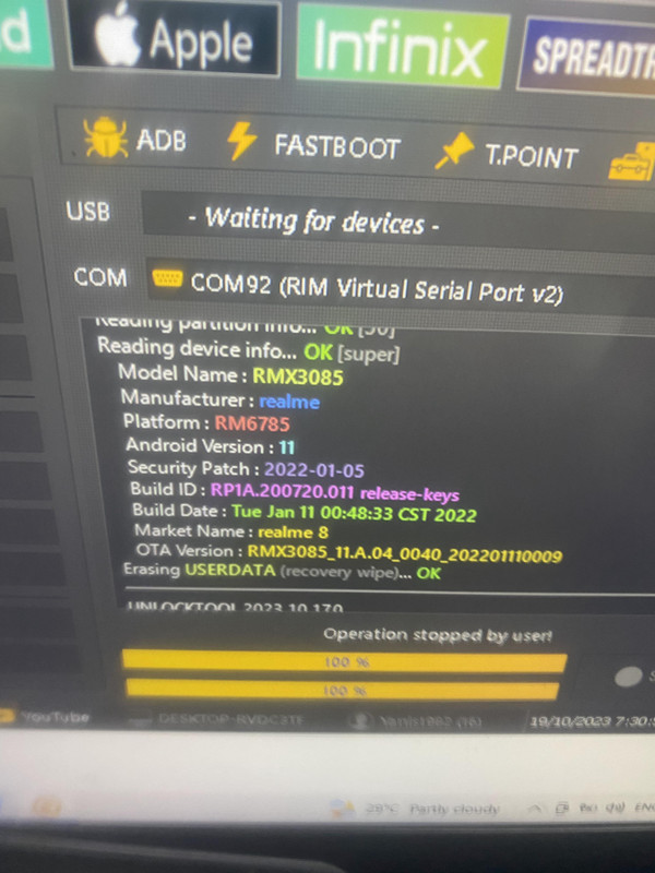

una kong ginawa ERASE FRP success naman pero may password pa rin.
pangalawa kung ginawa SAFE FORMAT success nman pero may password pa rin.
pangatlo kung ginawa FACTORY RESET + FRP success nman pero ayun stuck up sa recovery mode.

dito try mo https://realmefirmware.com/realme-8-firmware/
Go to Mediatek > Check Preloader Auth > OPPO REALME > FORMAT DATA > Method 4 - Quick Format (2).

w8 mo lang minsan matagal naka stuck sa recovery. pag ayaw parin
wag mo sya e flash sa hydra mo tirahin
procedure open hydra mtktab
1-Boot info
2-Ultra power option
3-Method option Rebuild User data
4-execute mag rereset yan w8 mo lang
