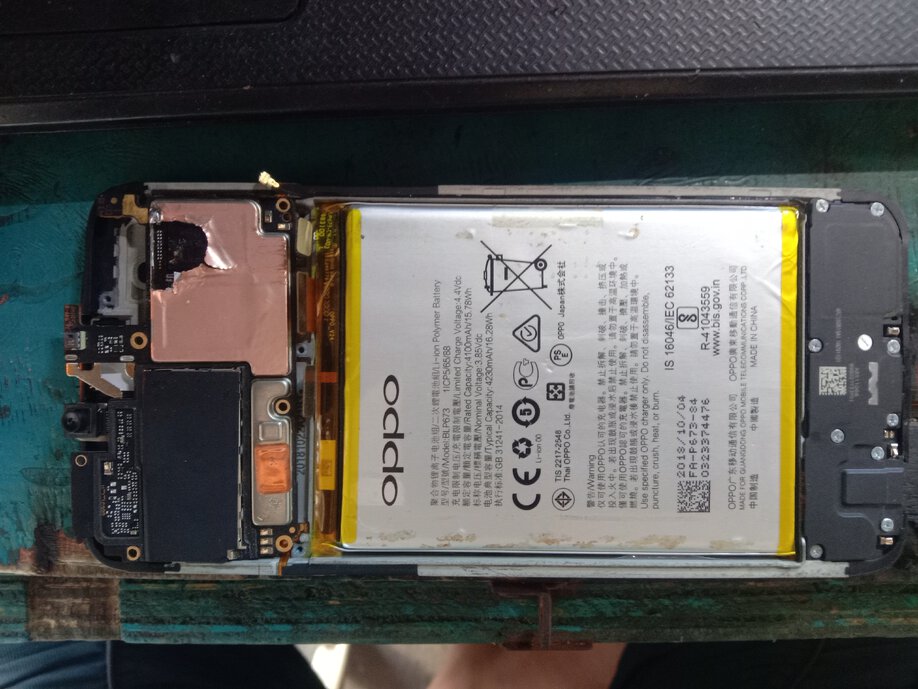

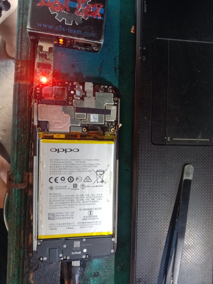

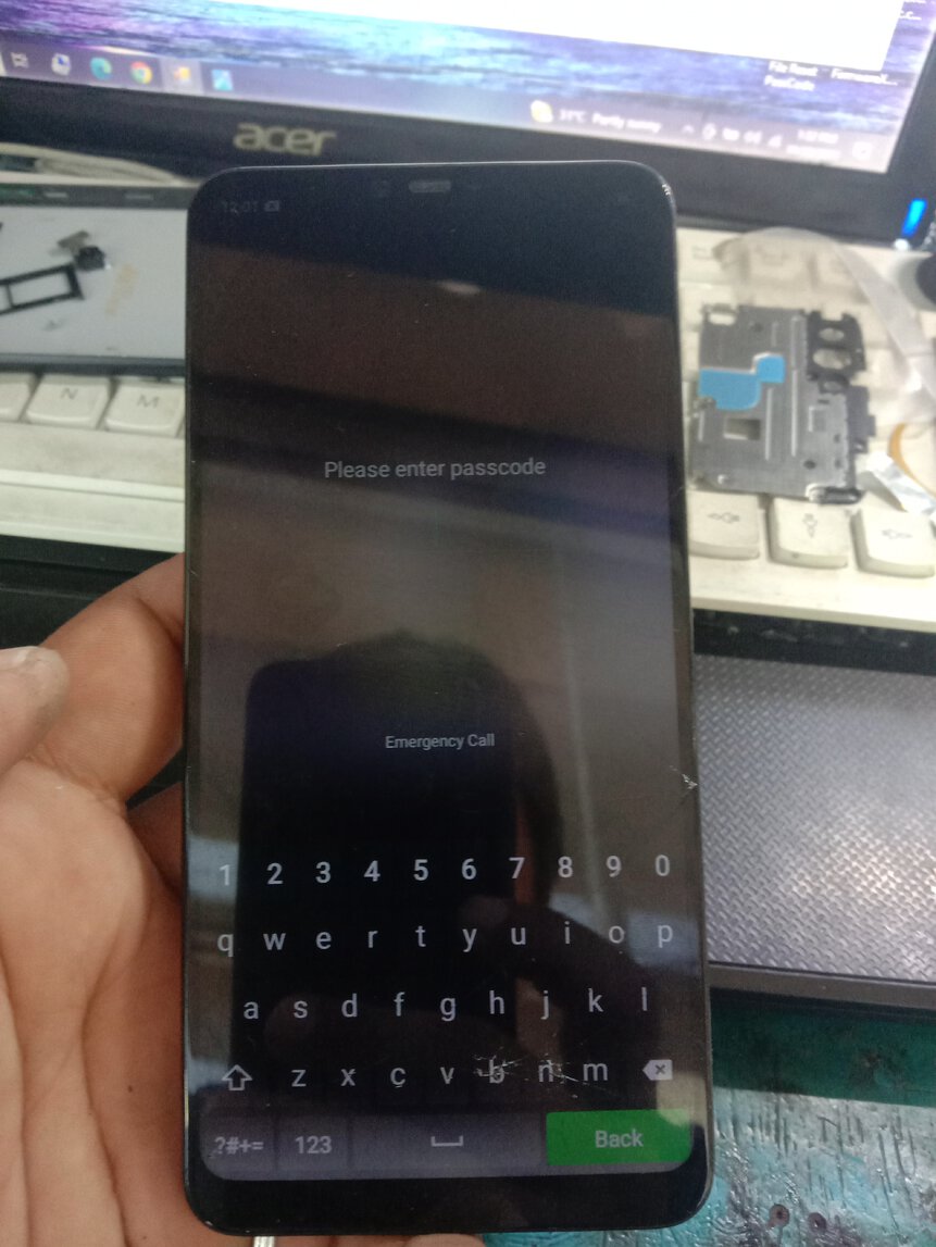

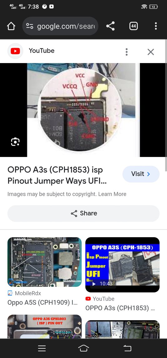

gud eve mga boss share ko lang itong realme c1 password
tools usb ung pang efixer dko alam pangalan nyan see pic nalang...
ito pala pin out pang oppo a3s cph1853

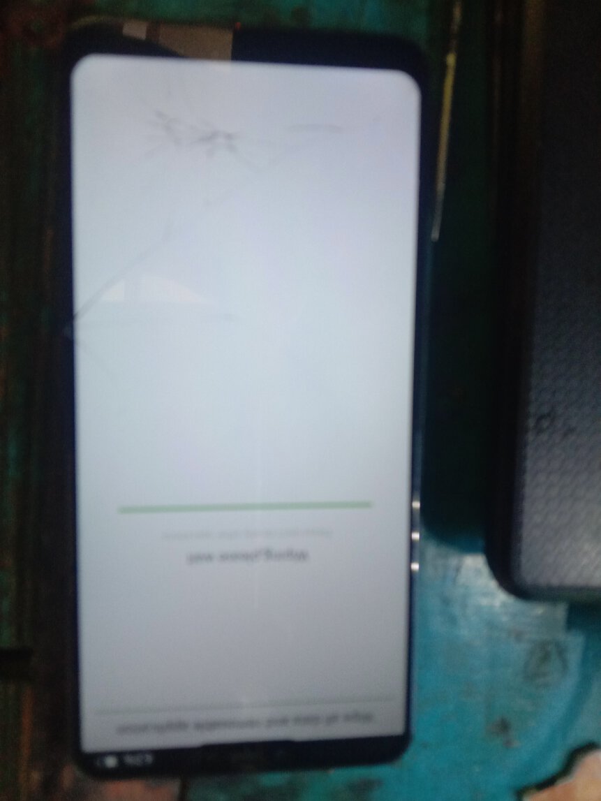

pgmag blink ung red light connected na yan...

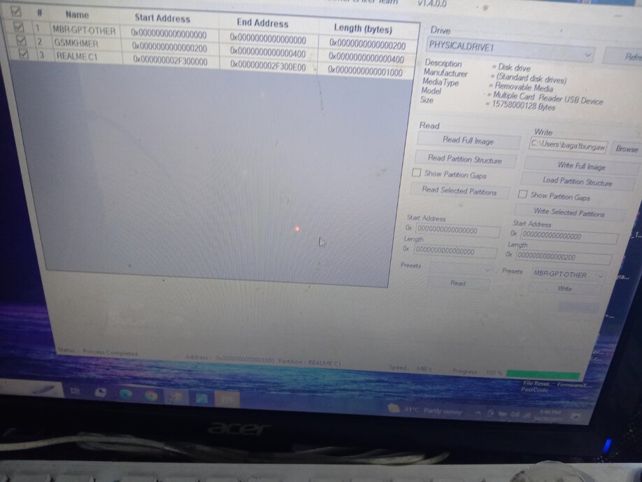

open efixer tool..
brows ung reset file rmx1811
load partation structure..
write selected partation..
reset complete done na yan..

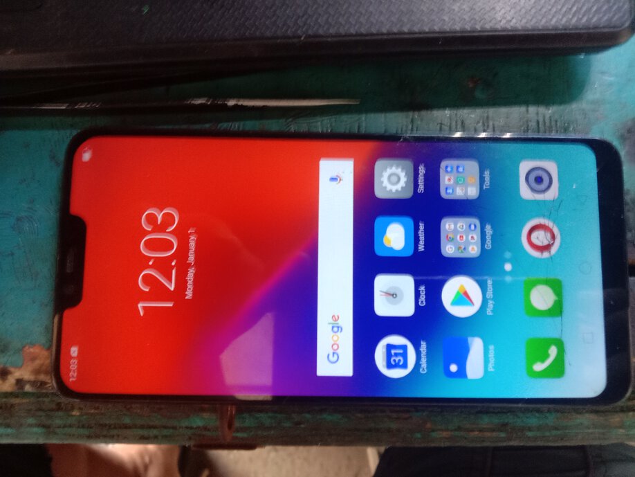

sundan nalang..

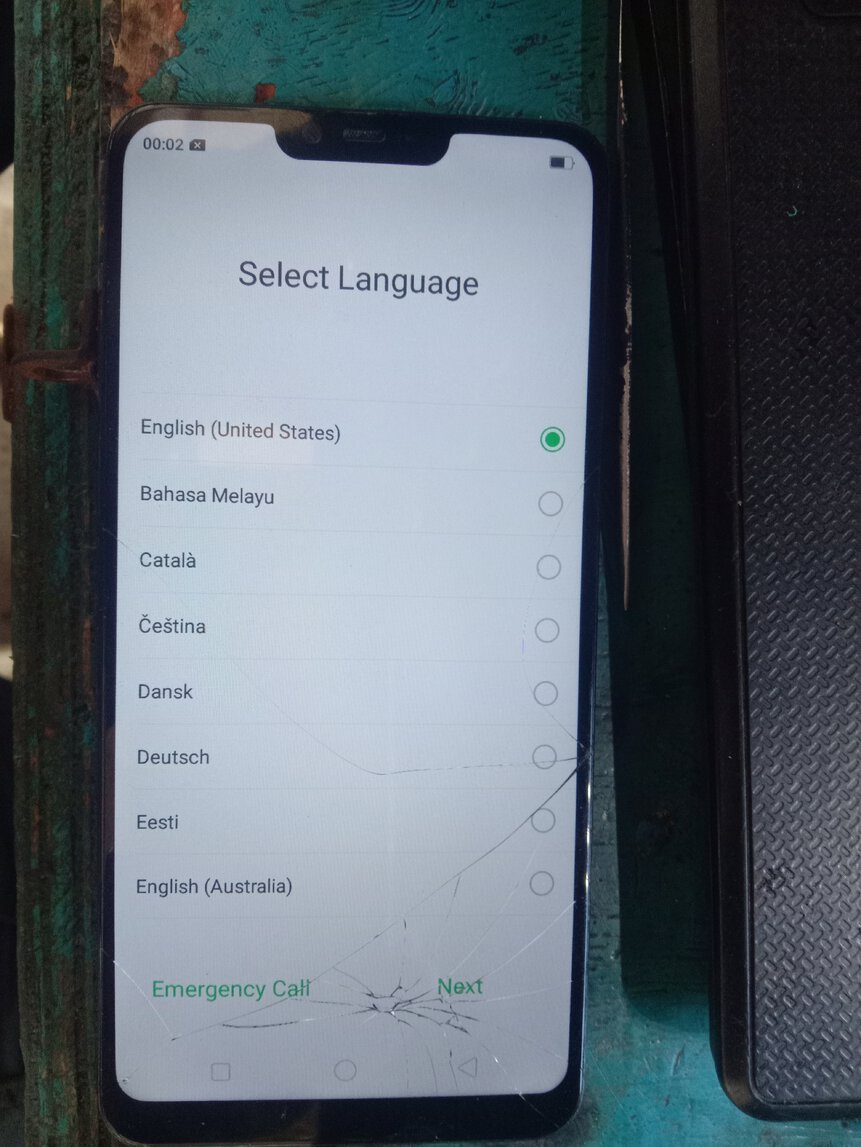

pgkatapos mareset sa efixer..
auto format na..
dial *#813# done na..
senxa na cp lang gamit ko na pgpost..

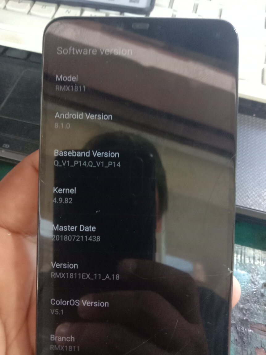

boss baka pweding pa share ng firmware boss.
realme c1 rmx1811​
