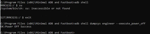

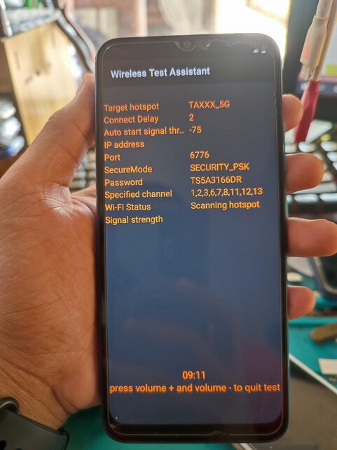

Issue:
Procedure:
1. Download and install Minimal Adb and Fastboot: https://www.mediafire.com/file/hpf0...s+Test+Assistant+)+FIX+DERRADJI+SOFT.rar/file
2. Open minimal adb. Phone must be power ON. Connect usb. Nandiyan na po ang "COMMAND" kasama ang installer. Paki follow nlng po.
3. Ito po yung command. Enter mu lng po kda command.
adb devices
adb shell
su
exit
adb shell dumpsys engineer --execute_power_off
4. At ito naman yung finish command nya..
done....

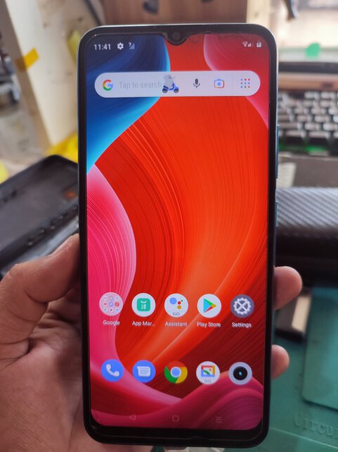

Finish product:
sana makatulong sa inyo :D
Issue:
Procedure:
adb devices
adb shell
su
exit
done....
Finish product:
gumana sakin tu kasu walang imei at auto restart na unit... mukhang yung cellphone na may tama pero salamat master
/system/bin/sh: su: inaccessible or not found
yan ang sabi pang sa command na "su"
