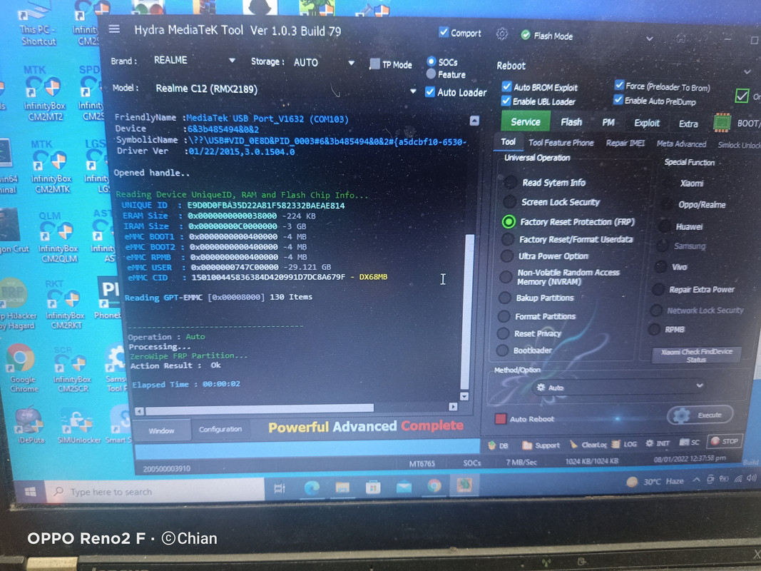

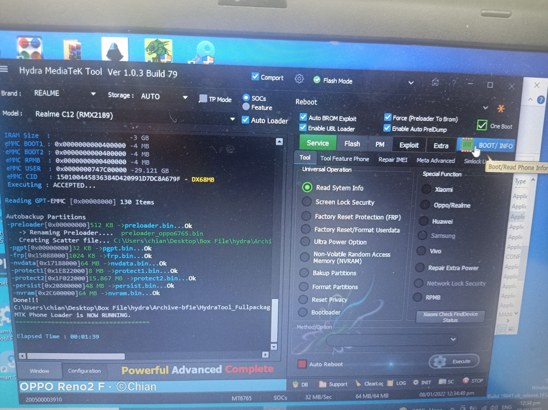

Open hydra mtk tool and search brand (REALME) and Select model (Realme C12 (RMX2189) and click 'BOOT/INFO' hold volume up and down at isaksak ang usb cable hintayin matapos ang info at backup security.
Pagkatapos ay wag hugutin ang usb. Click agad ang 'Factory Reset Protection (FRP) and click 'Execute'.

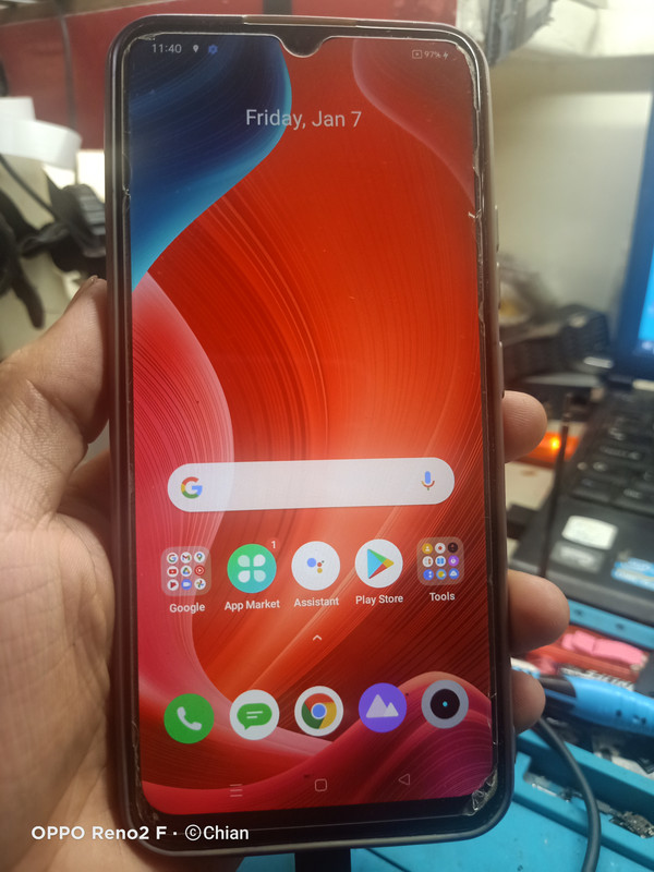

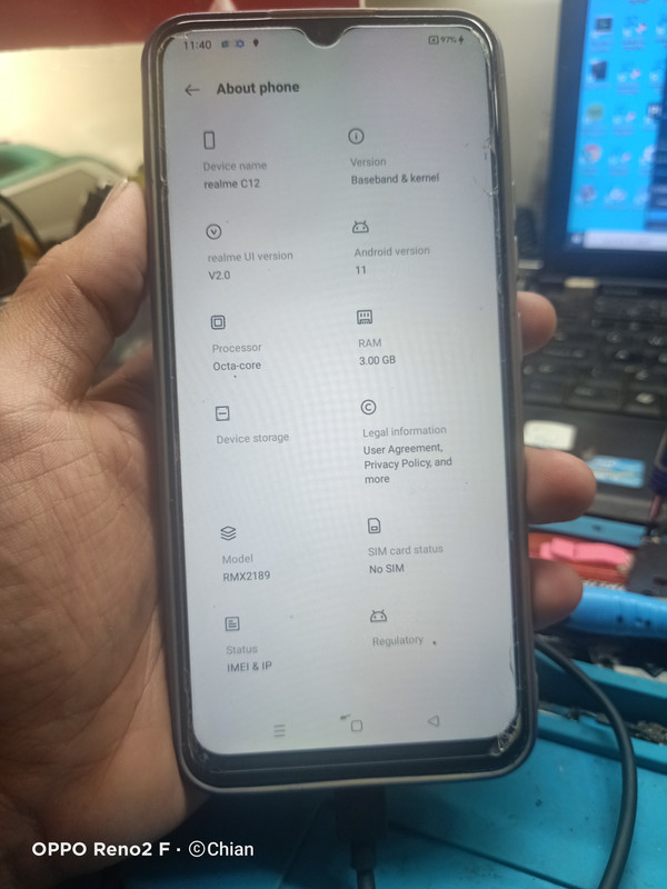

Heto naman po ang proof ko
