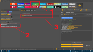

BAGGER Expired Account Joined Oct 18, 2021 Messages 620 Reaction score 561 Points 421 Location Cebu Jul 28, 2022 #1 TOOLS NEEDED USB CABLE PROCEDURE: 1. OPEN UNLOCKTOOL SOFTWARE 2. SELECT TAB OPPO 3. SELECT MODEL REALME C21Y V2 SPD 4. CLICK FACTORY RESET 5. NO BOOTKEY Done For FRP Dial *#813#
