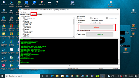

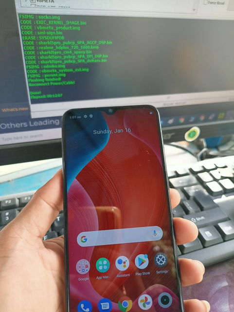

brand and model - Realme C21y rmx3261
problem - no power ( reset ni tumer sa setting pg reboot ay ayaw na mg power on )
BOOT KEY vol.up & down
nkadalawa na akung flash nya sa cm2 nabuhay sya kaso restart at unknowbaseband sa dalawang flashfile..need pala
ng mataas na version
solution : Open Cm2sp2 select Realme 3261
go to flasher tab and load pac file
search mo lng model number
