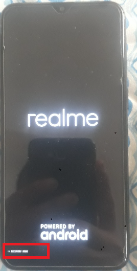

Pag charge mo mag Turn on na may naka appear na Recovery Mode tapos magturn off and magturn on paulit ulit.

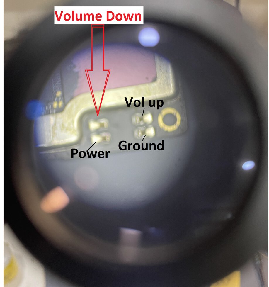

check resistance via diode mode ang terminal sa board
Diode resistance value guide:
Vol up - Normal value - 0.729
Vol Down - Normal value - 0.685 / reading ko sa unit abnormal 0.290 lang
Power - Normal value - 0.966
so sa Volume Down ako nag focus dahil 0.290 lang

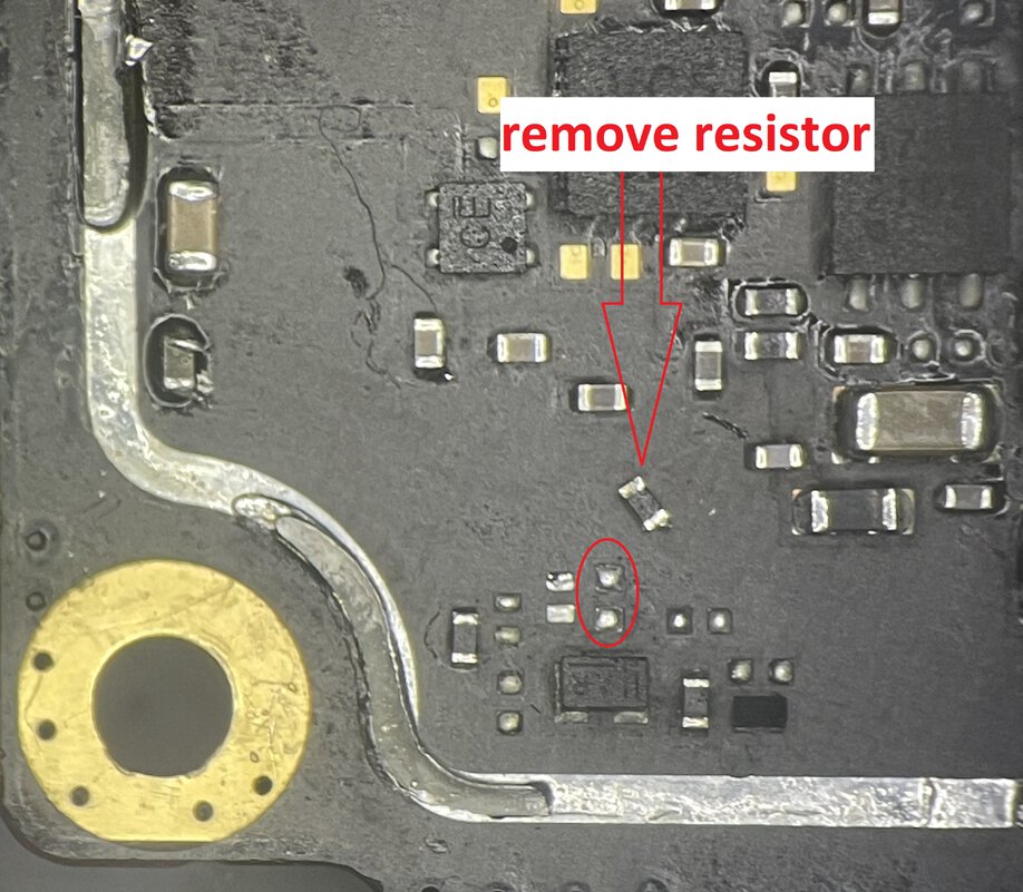

hacks solution:
tanggalin ang resistor Test the unit
at magiging okey na
Alams na..
before the repair process
check resistance

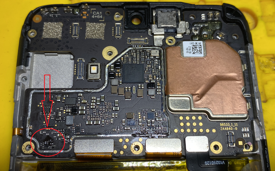

Alisin ang cover shield
simple hacks solution

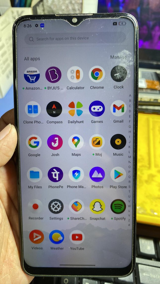

fixed
