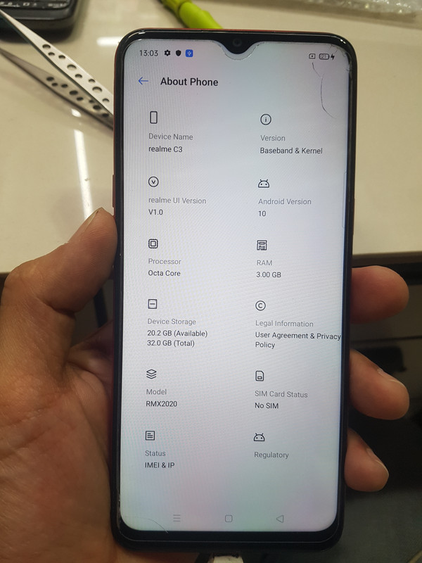

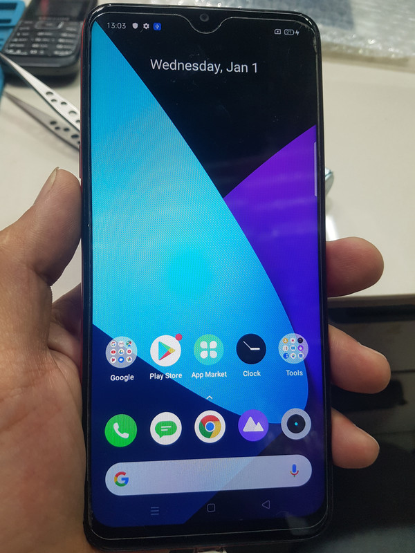

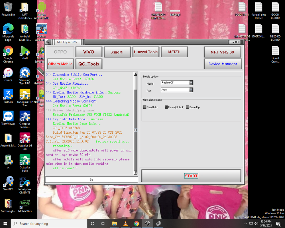

Requrements:
1. Mrt Dongle Updated
2. Good Internet Connection (di gagana si MRT pag walang net
password pattern lock
open mrt v.3.95
oppo
selected model realme c11
format
start
phone must be off
hold volume up and down then connect usb
if detected, metamode appear on screen
wait a seconds until process completed
done...
