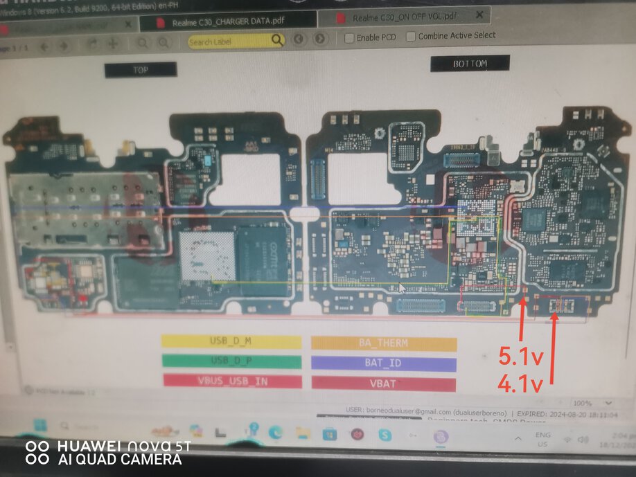

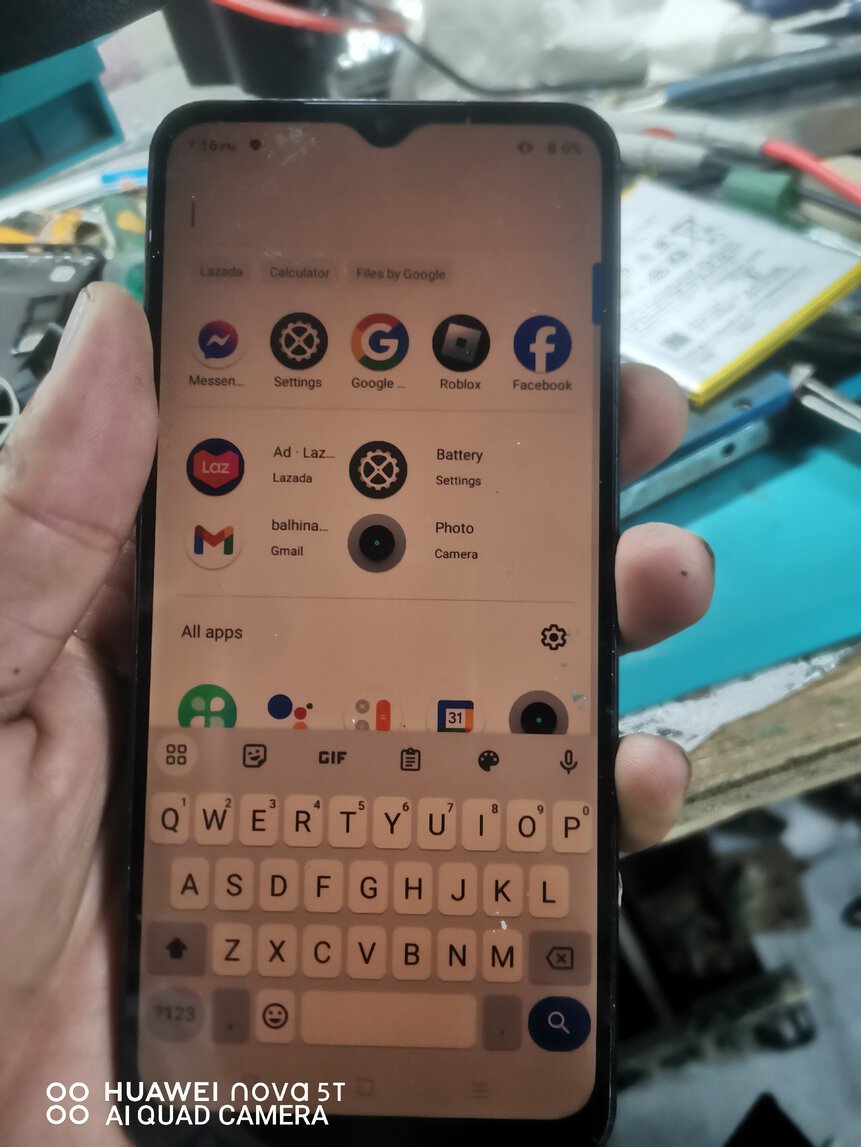

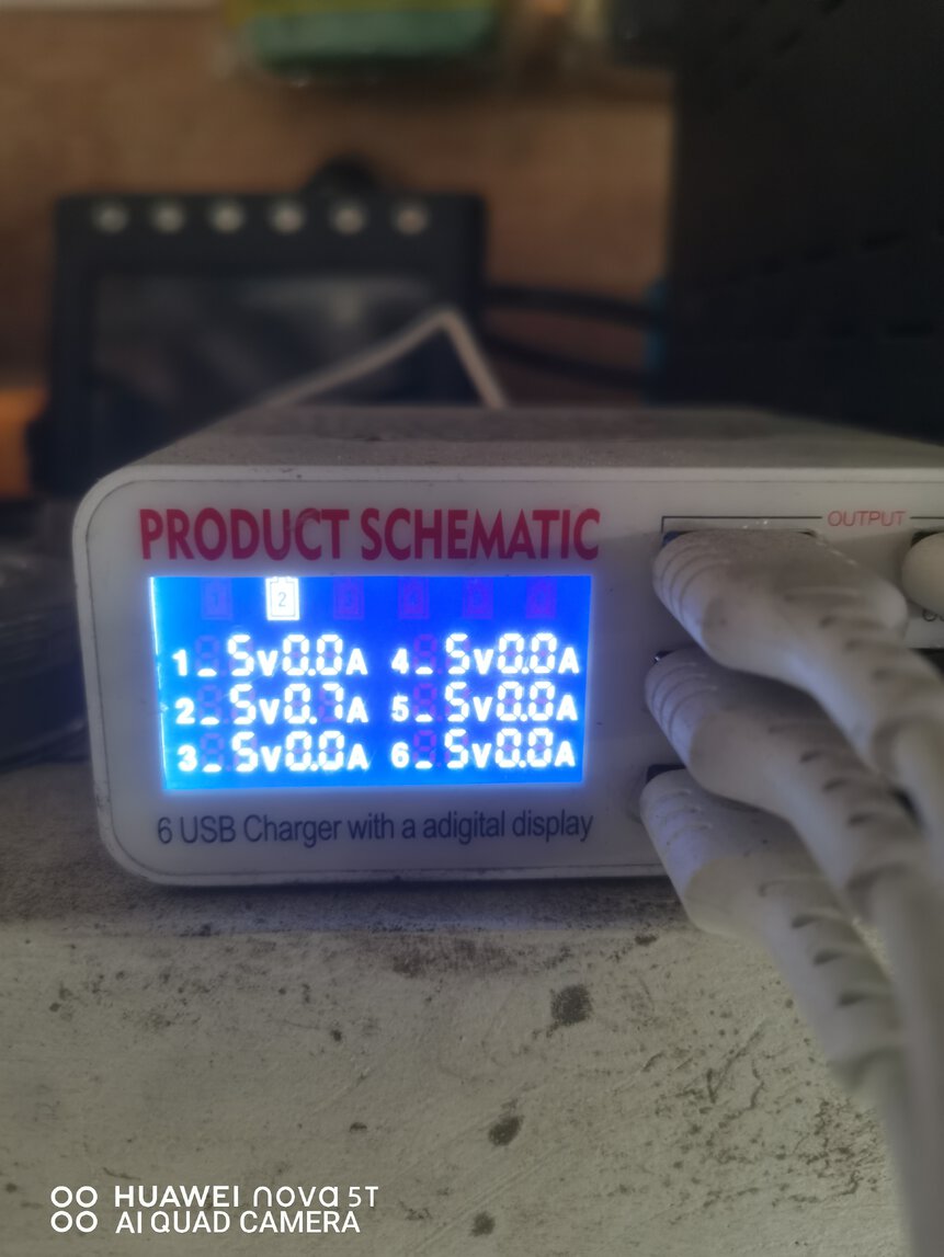

Buhay naman po yung unit
Voltage checking. Vbus 5.1v
Vbat 4.1v if battery hang.
3.7v if battery attach.
Pero hindi po sya nag charge.
See pic yan po ang palo nya..
Pero kung patay ang unit. Tulala lang sa charging logo..
Pero kung open ang cp naka 0% lang level ng battery..
Baka my naencounter po kayo gaya neto afphingi po advice. IMG_20231218_140839.jpg

Nag try ka na po ba with bagong charging pin, charging board or new batt?

try mo main flex palitan minsan sana flex nayan if ayaw parin nasa connector sa board mismo check mo daw..
try mo amo jumper positive line charging board to main board
minsan kc kahit may pumapasok na voltahe pa tester pero pag e charge bumibigay positive line
