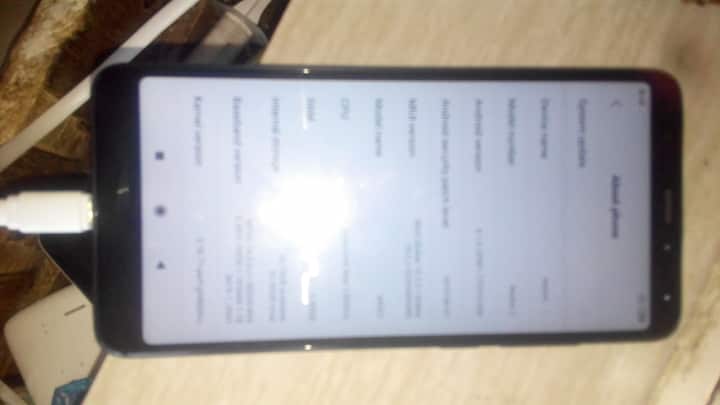

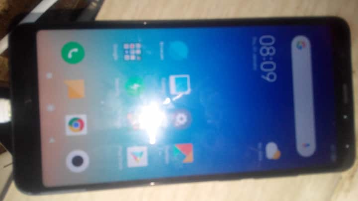

share ko lang gawa ko redmi 5 nakalimutan daw password
ginawa ko sa MRT done

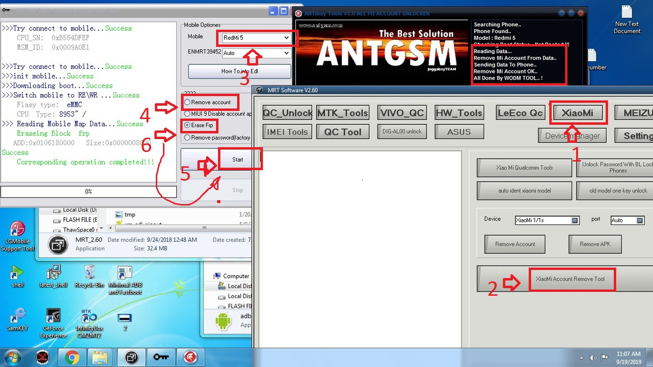

sa password reset muna natin VL,UP POWER
pag ok na gamitin mrt
1,open MRT V2.26
2,XIAOMI
3,xiaomi acount remove tools
4,mobile redmi 5
5,remove acount
6,erase frp

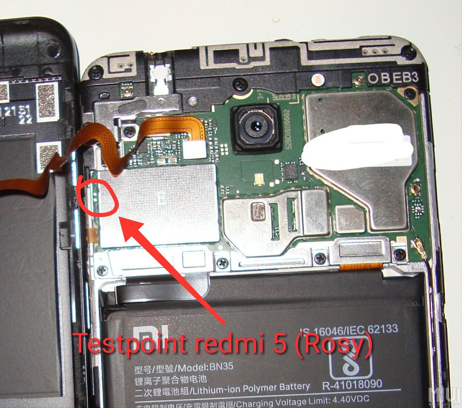

7,buksan ang unit ground mo TP saksak usb pag nadetect na PRESS STAR BOTTON
REMOVE ACOUNT MUNA BAGO ERASE FRP ULITIN MULANG,,
