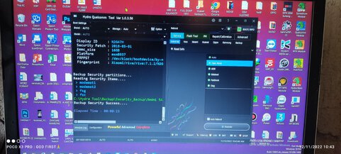

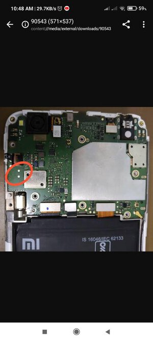

1 BAKLAS BACK CASE KASE MAG TTP TAYO SEE IMAGE BELOW SA TP
2 OPEN HYDRA TOOL
3 SA BRAND AUTO LANG & CLICK BOOT INFO
4 TP & CONNECT USB CABLE

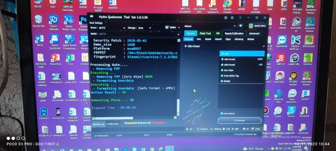

5 AFTER BOOT INFO SUCCESS SELECT ULTRA POWER CHOOSE AUTO
6 CHECK AUTO REBOOT & CLICK EXECUTE WAIT GANG MATAPOS

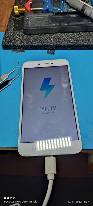

DONE
SEE IMAGE BELOW
