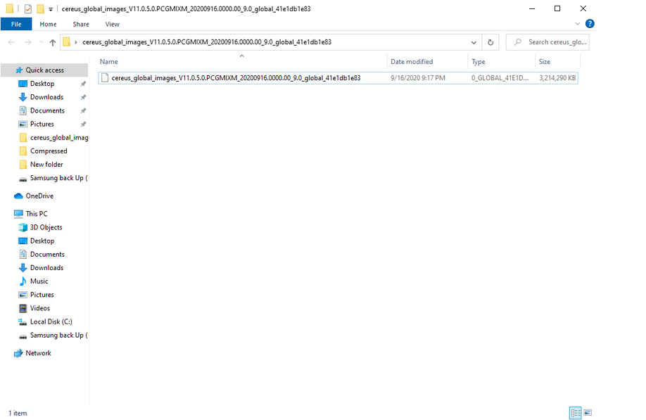

Procedure:
Tools Needed
Unlocktool
Usbcable
1. Open Unlocktool
2. Select TAB MediaTek
3. Go to Flash Section
4. Select Model Xiaomi
5. Model : Xiaomi Redmi 6 [Cereus]
6. Select Perm | Unlock BL
Bootkey Vol up and down for Fastboot
then Power on para mag loading at dumiritso sya
Then Proceed na tayo para mag convert na
1. Open Unlocktool
2. Select Tab Mediatek
3. go to Flash
5. Model : Xiaomi Redmi 6[Cereus]
6 Load at scattrerFiles : https://bigota.d.miui.com/V10.3.6.0...XM_20190823.0000.00_8.1_global_1c888d5868.tgz
7. Then Pindot mo Flash
8. Bootkey Vol up and Down
Ayun Wait mo Lang Pera na
done
