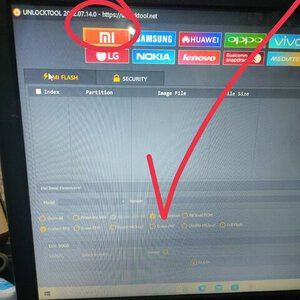

Open unlocktool
Click mi tab

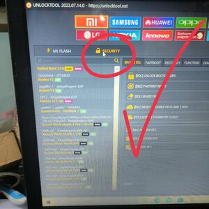

Click security

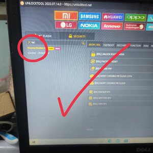

Type 6a

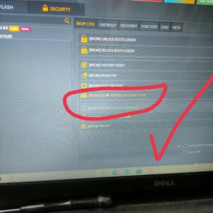

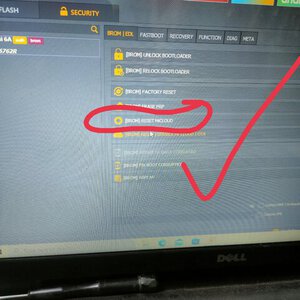

Click [brom] reset micloud
Off unit hold vol up/down connect to the PC
After finish. Click [ brom] reset | disable mi account | ota IMG_20220720_152151.jpg
