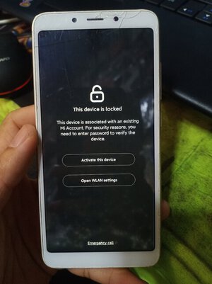

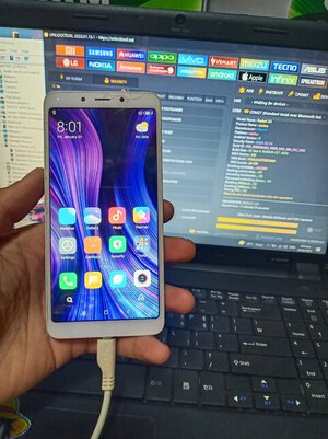

Redmi 6A Mi Cloud
Procedure
OPEN Unlocktool
1. Click: Mi Platform
2. Search Model: Redmi 6A
3. Select: [BROM] RESET DISABLE MI CLOUD | OTA
4. BAKLAS Unit para Ma off
5. Hold Vol Up & Vol Down then Connect Usb cable
