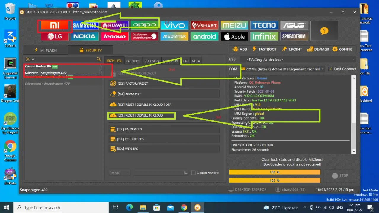

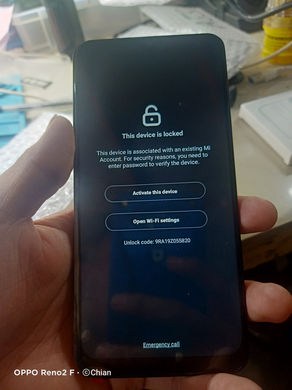

Good day po sa inyong lahat. Today may tanggap po akong redmi 8a mi account problem
Proceed po tayo sa process

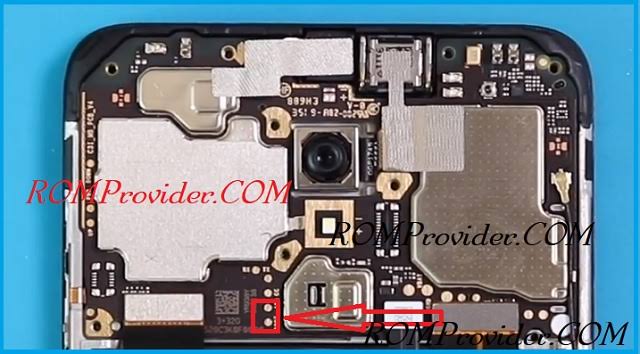

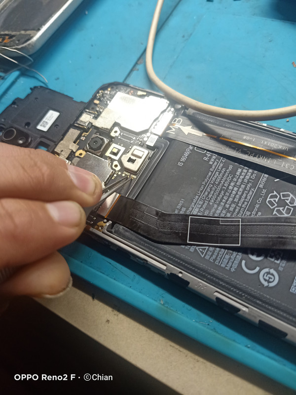

First tp muna
And insert usb cable
Now open unlock tool select brand 'Mi' next search model '8a' and click [EDL] RESET I DIDABLE MI CLOUD.

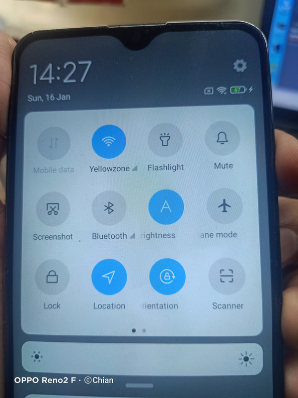

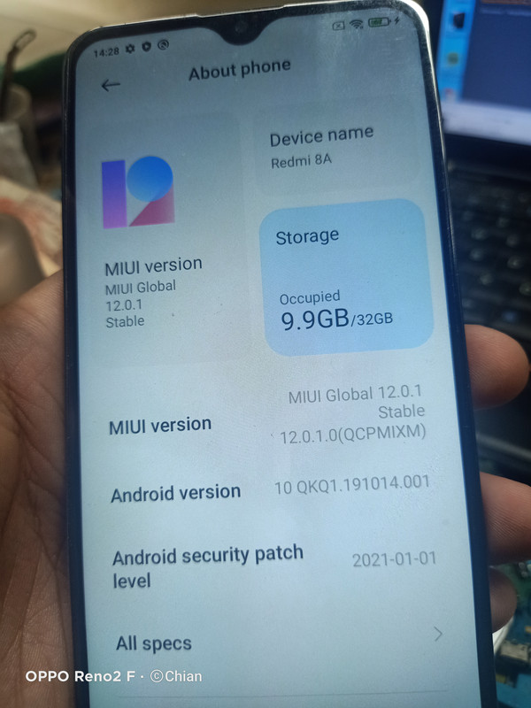

Heto naman po ang patunay ko
i will like
Take note: abisuhan po si customer agad na bawal i update.

ok lang ba sir kahit factory reset basta wag lang update?
Edit: Relocked sa akin nireboot lang ni tomer
Edit uli: nag popup update pinindot ni tomer di inamin pag pindot daw play store nag relocked na ss ko logs kaya nakita ko na update kala ko relock na..
